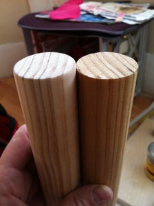

Step 2: Prepping the Table for Stain
Thoroughly sand all wooden pieces- plywood top, phone stand piece & dowel legs. Most scrap wood needs a lotta sand lovin so begin with a 120-grit and graduate to 180-grit after a nice dose of sanding. Finish off with a 220-grit to ensure a smooth surface.
To produce a nice rounded effect (see image below) take your sandpaper and wrap it around the dowel moving it in a circular motion around the end of the dowel. Clean down the table (and your nose) of all sanding dust. I used a damp cloth and then just allowed it to dry for a minute.

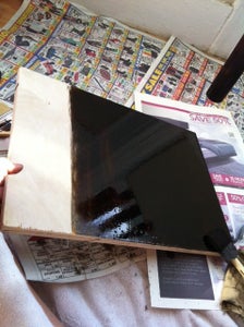

Step 3: Time to Stain!
I wanted a wood stain that would complement the color of natural cork. After digging through some samples at my hardware store, I found dark walnut which is bold and rich enough for the corks. No clashing here! There are many other colors available and even a polyurethane and wood stain in one (PolyShades by Minwax). It is convenient for those of you who do not want to wait days to apply multiple coats of either. I would recommend the Bombay Mahogany or Antique Walnut in Minwax Polyshades if convenience is more your thing.
To Wood Stain:
-Apply wood stain, even brush strokes are best.
-Allow for a nice dark layer on the wooden pieces
-Let sit for 3-5 minutes (Directions on can may say longer but dark walnut really saturates the plywood)
-Take wiping cloth and wipe off excess stain from wood
-Leave to dry for a day
-Admire the effects of stain!

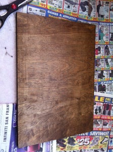

Step 4: Apply a Polyurethane Coat
I chose a semi-gloss polyurethane coat for the glossy effect. For this a natural bristle brush works superb.
I applied two coats between two days (to allow for proper drying).
-Prior to poly coating #1, sand lightly with a 220-grit sandpaper.
-For polyurethane, lathering on thick heavy coats is unnecessary, two thin coats work best and will eventually dry faster.
-Even brush strokes
-Allow it to dry for a day
-After it is dry, repeat this process

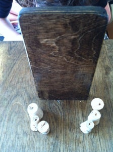

Step 6: Dock for Your Phone/Mp3 Player
This is the docking station for your music player:
-Pilot a hole in the center of the docking stand.
-Mark halfway the width of the board and about 5 1/2" from the back of the table (This is where the docking stand will be placed).
-From the marking point on the bottom side of the table begin screwing in your last #6 screw
-Once the screw is all the way through the board, you can basically take the docking stand and screw it in to the screw that is protruding through the center of the table.
*Make sure to squirt a little wood glue prior to screwing.
-Screw until the stand is centered and straight on the top of the table.
-Take your six small corks and place them (use your music player to ensure proper placement of corks) by nailing them through the center of the top of the corks and through the table until you can easily pull on the corks with no give.

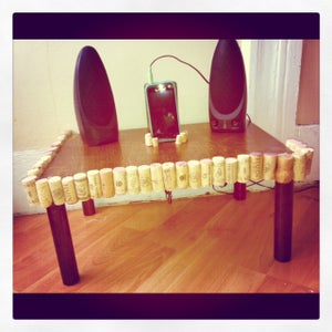

Step 7: Corks!
Now that you've had all that fun drinking 70+ bottles of wine, lets put 'em on the table!
Just kidding....kind of.
Unless you are that type of a wino, 70 corks can be hard to accumulate in a week. You can buy a pack of 50 online for around $15 but if you have some time to spare, head up to your friendly neighborhood bar and ask them politely to save their corks for you. Offering $$$ helps but most bartenders don't mind because the corks are thrown out anyway. Lasso two friendly bartenders from two different bars and you will have 70 in no time. (As you may have noticed, my finished table does not have corks all the way around...as of yet. My friendly bartender has a bag waiting for me, I was just too impatient and excited to write up my Instructables that I have yet to get them.)
-Begin to nail the brads into the corks and around the edge of the table. Hammer until the small brad nail head disappears into the cork. Magic!
-Line the edge with corks and continue until your corks have made it all the way around.
Step 8: Speakers
-Place speakers on both sides of the table.
-Plug in speakers.
-Turn on James Brown
-Pour a glass of wine and show it off to your friends!
