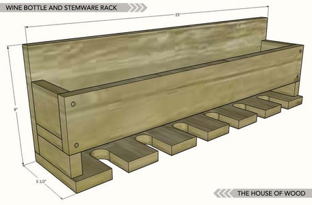

Materials List
- 25″ of 1×6 = 1.042 BF
- 25″ of 1×8 = 1.389 BF
- 9″ of 1×2 = .125 BF
- 1 – 1x4x6′ = 2 BF
- 1-1/4″ Pocket Hole Screws
- 1-1/4″ Wood Screws
- 1-1/4″ Brad Nails
- Wood Glue
- Hanging Hardware
4.556 BF * $4.75 = $21.64
Cut List
- 1 – 1×6 @ 25″ (stemware hanger)
- 1 – 1×8 @ 25″ (back)
- 2 – 1×2 @ 4-1/4″ (sides)
- 2 – 1×4 @ 25″ (ledge and front)
- 2 – 1×4 @ 2-3/4″ (sides)
Tools
- Tape Measure
- Pencil
- Speed Square
- Drill with Countersink Drill Bit
- Circular Saw
- Kreg Jig
- Jigsaw
- Brad Nailer or Hammer

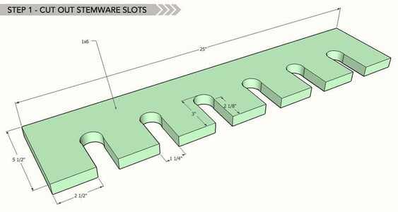

Step 1: Base
Using a jigsaw, cut out the stemware slots as shown

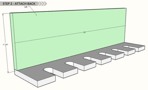

Step 2: Attach Back
Drill 3/4″ pocket holes into the back board facing down and use 1-1/4″ pocket hole screws to attach it to the stemware rack. Alternately, you can use 1-1/4″ brad nails and wood glue to build this wine rack.

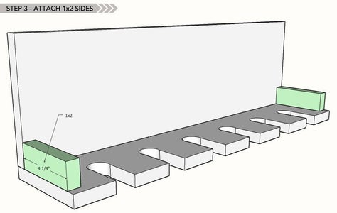

Step 3: Attach 1x2 Sides
Attach the 1×2 side pieces with 3/4″ pocket holes and 1-1/4″ pocket hole screws. Attach the 1×2 to the stemware rack with 1-1/4″ brad nails nailed from underneath.

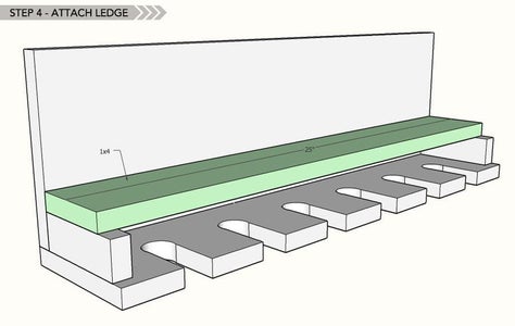

Step 4: Attach Ledge
Drill 3/4″ pocket holes into the 1×4 ledge and attach it to the back with 1-1/4″ pocket hole screws. You can also nail in 1-1/4″ brad nails on top to attach the ledge to the 1×2 sides.

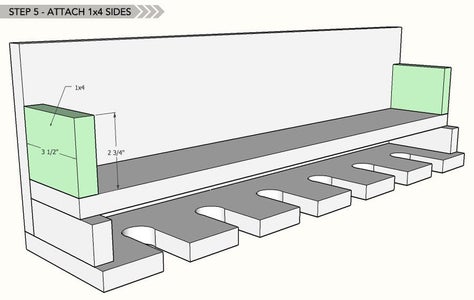

Step 5: Attach 1x4 Sides
Drill 3/4″ pocket holes into the 1×4 sides and attach it to the back with 1-1/4″ pocket hole screws. Use glue on the joint where it meets the ledge.

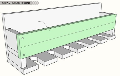

Step 6: Attach Front
Pre-drill countersunk pilot holes into the front board and attach with 1-1/4″ wood screws. Fill the holes with wood putty or wood plugs.
