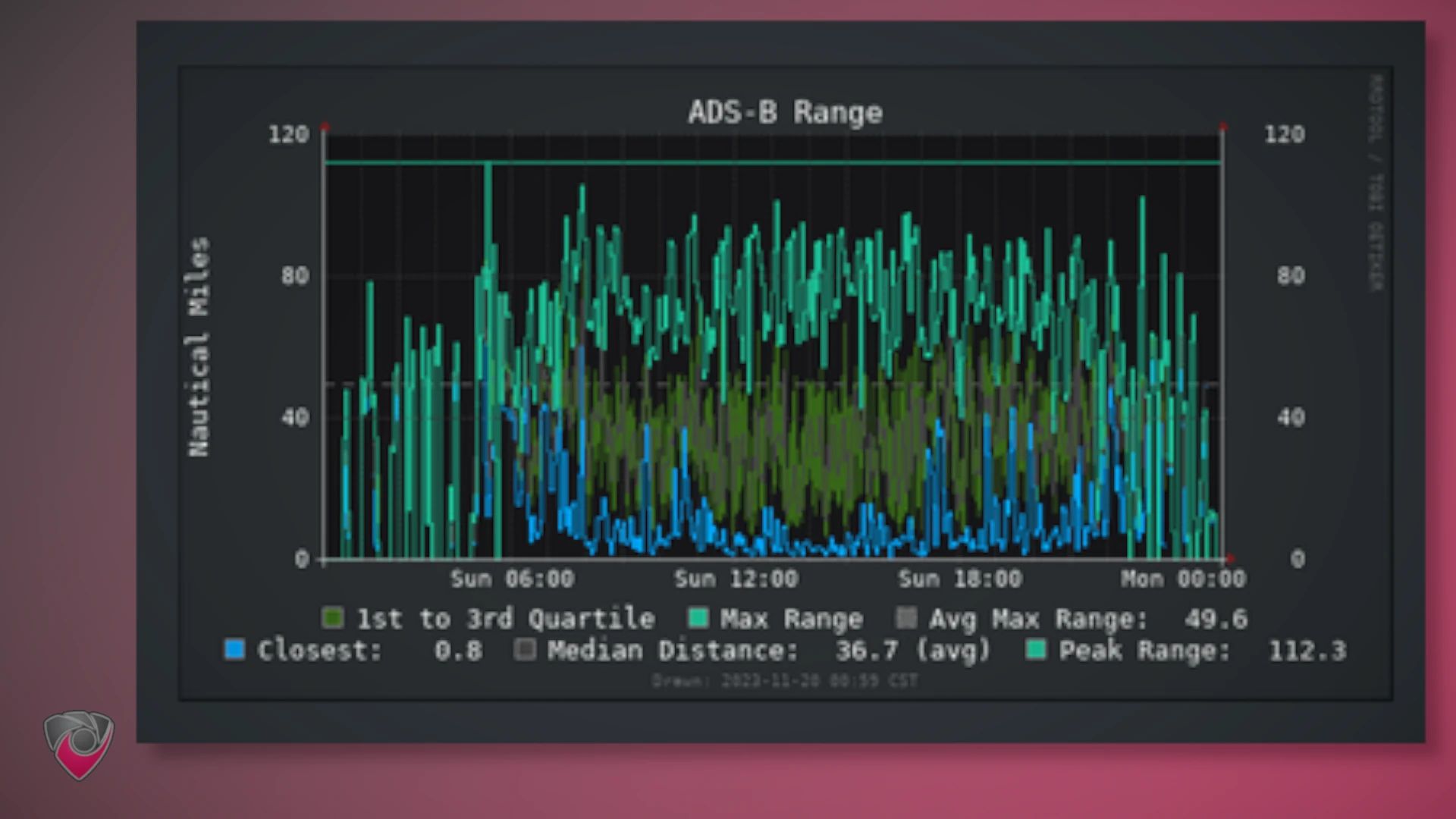

3: Optimizing Gain Levels
Now, it’s time to optimize your receiver’s gain levels. Run the following
command, if it fails, come back to this step after a few minutes.
4. Profit?
At this point you’re done. Sit back and relax.
