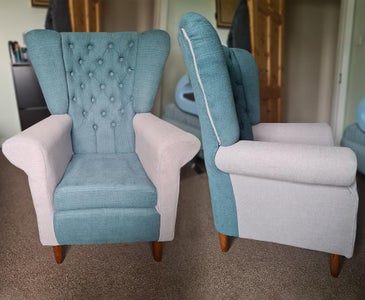

Introduction: Wingback Armchair Full Build and Upholstery | Whitehorn Studio Woodworking
This project came about as I have always had an interest in woodworking and wanted to combine this with a new interest in upholstery. This was the first time I had attempted to make an armchair from start to finish.
This is a project involving multiple different skills and if you have not done many of them before it can take a while to get each step right. Persevere with it and you will have a great chair to relax in for years to come along with some new skills. If you like this guide consider subscribing to Whitehorn Studio Woodworking.

Here you will need to calculate the fabric piece size you need. If you went with diamond tufting you will need to measure the width of the back(without the wings) and add the depth of the foam(2") times the number of holes, plus overhang to staple to the back.
e.g. I have 4 holes across and my foam is 2" thick, if the width of my seat back is 20" I would add 20" + 8"(4x2") + 6"(3" overhang each side) = 34" wide. Do the same calculation for top to bottom size.
The tufting process is one that takes a bit of practice and would be an instructable in itself, therefore it is best learnt by following a video tutorial, of which there are many available on youtube.
The basic process is to mark out your fabric with the same pattern as your button holes, keeping in mind the distances between holes will be different based on foam depth. Then you will thread a needle with a button and thread, push the needle through the front of the fabric, through the 25mm hole and out the back of the chair, pull the button tight and staple the twine to the back supports, fold twine over and staple multiple times.
After tufting is complete you will need to staple all around the edge of the fabric to the back of the chair.

Step 17: Seat Cushion
Supplies:
3" Foam Block
Wadding
Fabric
Zipper
- Firstly cut a piece of fabric to go under the cushion. This will also come down the front of the chair and slightly under. Cut just wider than you need so you can fold the sides in.
- Staple to the back, pull tightly forwards, fold under the chair and staple underneath to the front of the base.
- Pull the sides through the gaps and staple from the outside of the arm structure.
- There is many great videos on sewing cushions with zips on youtube. Based on the size you want the cushion to fit snuggly into your chair you will need to measure 4 pieces of fabric for the sides of the cushion and 2 pieces for the top and bottom. Remember to add seam allowance.
- Sew the back piece with the zip and then sew all these pieces together.
- Wrap your foam block in wadding for a softer feel and to prevent fast wearing of the fabric.
- Stuff your block into the cushion cover.

- Once ready spray the back and sides in sections and apply pressure to the chosen backing.
Step 20: Piping and Upholster the Back and Sides
Supplies:
Fabric
Piping Cord
Cardboard Back Tack
Metal Tack Strip
Cambric
- For the piping you will need to cut a piece of fabric the length of the area you want to cover and 2" wide
- Place your piping cord in the middle of the fabric, fold the fabric over and, with your sewing machine, sew as close to the piping cord as possible so that it does not move around inside the fabric.
- Place the prepared piping on the chair and staple it on, keeping the staples close together so there is no movement in the piping.
- Next measure out 3 pieces of fabric, one for the back and 2 for the sides, remember to increase measurement for seam allowance where the back and sides meet. Leave about 2 inches at the bottom of the back and sides. Leave about half inch at the front of the sides and along the wing outline. Leave about an inch at the top of the sides.
- Sew the back and sides together.
- With the fabric draped over the front of the chair, standing at the back, place the top of the back, face down, along the top edge against your piping.
- Overlay with the cardboard back tack and staple down. Let your fabric hang down the back of the chair.
- From the edge of your back tack, down the wings to where it meets the arm, staple your metal tack strip right up against the piping.
- Put the half inch allowance you left earlier into the metal tack strip and fold it over. Use a clean rubber mallet to flatten it down.
- Repeat the same steps with cardboard back tack at the top of the sides and metal tack strip down the front of the sides.
- Fold the remainder of the fabric under the chair and staple to the underside.
- Cut a piece of cambric the size of the bottom of your chair, adding an inch all around.
- Fold an edge under itself and staple down, repeat all around to seal the bottom of the chair.
Step 21: Sit Down and Relax in Your New Chair
Supplies:
You and your newly built chair
Thanks for taking the time to read my very first Instructable, I hope you enjoyed it and learned something about the furniture build process and what goes into building and upholstering a piece of furniture. I will have more videos/tutorials like this in 2023, to keep up to date please subscribe to my youtube channel Whitehorn Studio Woodworking
