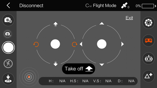

I left the program unconnected for this picture so you could get a good idea of what the controller layout is like. As a person who has been flying RC with real radios for years I was a bit skeptical on how I would be able to fly the S6 using my phone. But In all honesty after a flight or two you can almost "feel" the sticks. It's weird, but the system works for this size of drone.
You will also notice that on the left are all your camera settings and on the right are all your drone settings including POI and Follow me (The robot head)

NOTE: to access most settings you need to hide the gimbal screen by tapping the little radio signal. Kind of weird to not have sticks available as the drone is flying when you want to change a setting. But You get used to that as well! Let's go over all the functions.

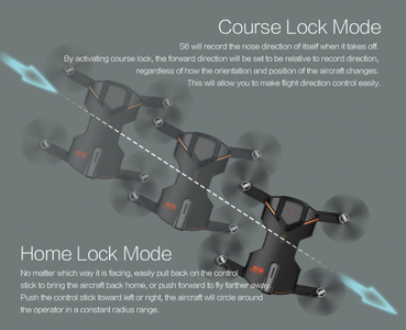

Course Lock and Home Lock Modes: I hate these modes and think if you can't actually fly a drone you shouldn't so yes they work, but I hate them. (Honesty it hurts some times)
