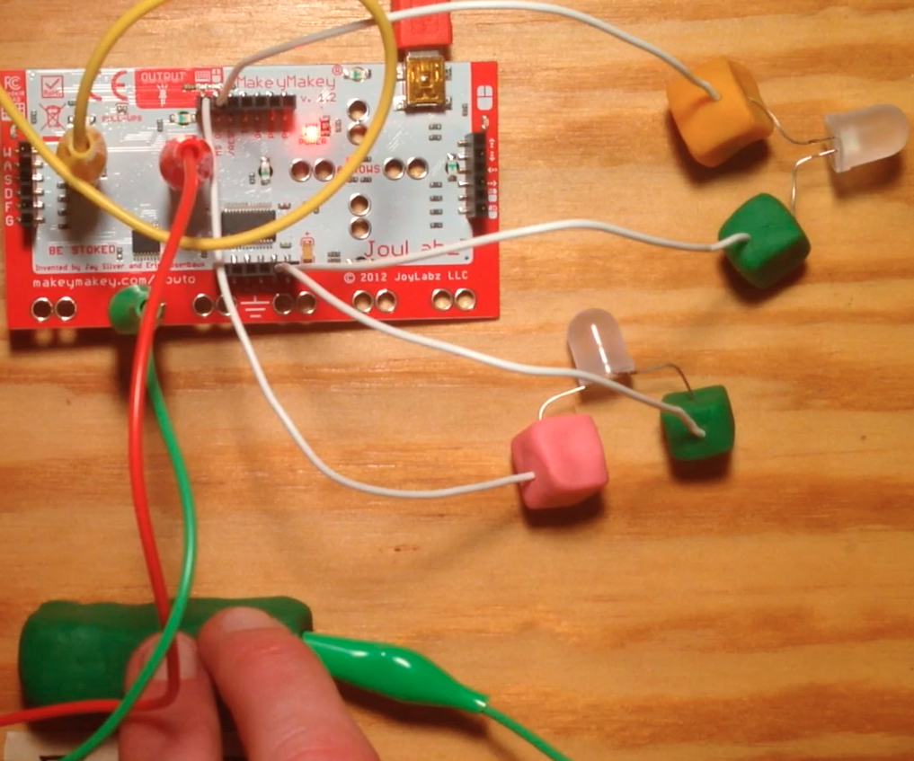

Connect it to your Makey Makey.
The scratch project I made for this game uses LEFT ARROW, RIGHT ARROW, and SPACEBAR.
SPACE connects to the wire
RIGH & LEFT ARROWS connects to each of the washers
EARTH connects to your wand
