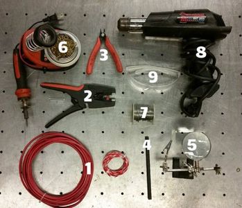

Step 1: Tools/Materials:
  • Wire (copper, preferably stranded) [1]
  • Wire strippers [2]
  • Dikes (cutting pliers) that match the wire size [3]
  • Heat shrink matching the wire size (generally 1.5X the diameter of wire) [4]
  • Wire holder (optional) [5]
  • Soldering iron, preferably temperature controlled (with a dial and display) and a sponge [6]
  • Solder 40/60 rosin core (lead free if possible) [7]
  • Heat gun [8]
  • Safety glasses [9]
  • Jeans (recommended) [not pictured]

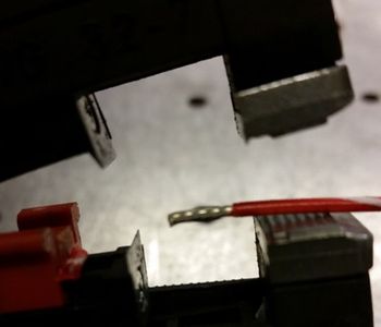

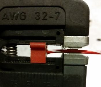

Step 4: Strip the Wires:
Strip approximately three times the diameter of one end of each wire (stripping is removing the insulation from the wire to expose the copper strands) using wire strippers. A razor blade is often required to strip larger gauge wires.

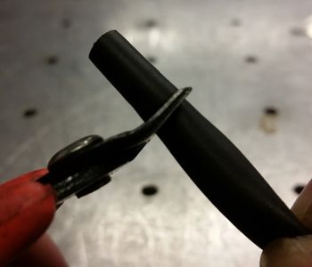

Step 7: Cut and Place the Heat Shrink:
Cut a piece of heat shrink 1cm longer than the stripped wire that has the most exposed copper using dikes. This is to allow for 5mm of heat shrink on both sides of the splice.
Slide the heat shrink over one of the wires, past the tinned section.
If you are practicing, this can easily be done at a later step. However, it is good practice to do this before splicing wires, as it cannot be done so easily when the wires have connections at the other ends.

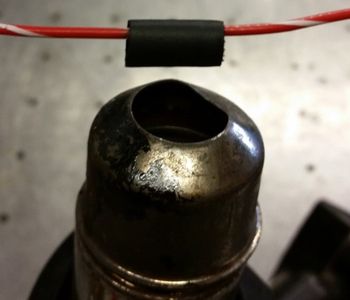

Step 9: Apply the Heat Shrink:
Slide the heat shrink and center it over the splice. Use the heat gun to shrink it by moving the gun around the heat shrink to get an even distribution of heat.
