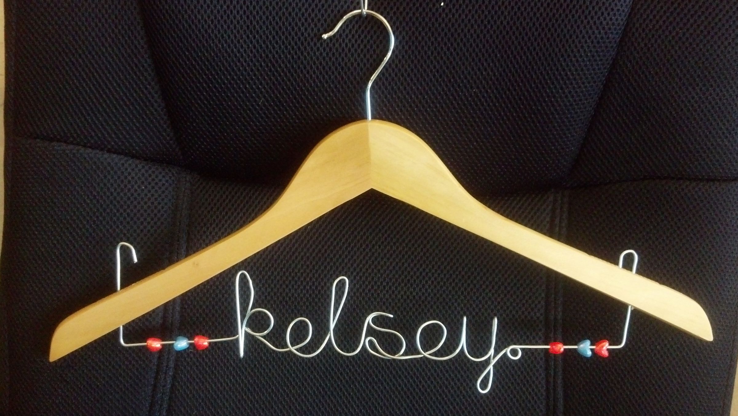

Wire usually comes in a spool format, but it's a LOT easier to work with when it's straightened out. But it can be a lot of work to make it straight... and it take a log of practice to do it by hand. But this simple gadget is fairly easy to create and saves hours of hand straightening wire. In this example I have 12 gague hot-rolled (soft) galvanized wire from Lowe's, but it works on spring steel wire as well
It's really cheap, fairly easy to make, and well worth the effort if you do any amount of wire work.
