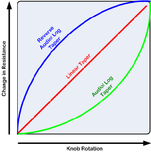

One thing you might want to keep in mind when using this technique is the taper of your pot. This pot has a B label on it, which means it is a linear taper pot. This means the resistance of the material inside the pot is uniform for all positions of the knob. If the knob of the pot is positioned exactly halfway between the two extremes, the resistance between the black wires equals 10kOhm/2 = 5kOhm. Position the knob halfway between this mid point and the right extreme and the resistance between the two wires equals 10kOhm/4 = 2.5kOhm. If the wiring is reversed (wires connected to the left and middle pin instead of right and middle) the pot is still linear but the knob positions of 0Ohm and 10kOhms have reversed.
If you have a pot with an A label on it it has a logarithmic taper: the resistive material inside the pot is not uniform. When you move the knob from the right extreme the resistance changes dramatically then becomes almost constant as you approach the left extreme position. So if you wire up the right and middle leads (as shown in fig 1) the dramatic change will happen as you approach 0Ohms resistance, but with the left and middle leads connected the dramatic change happens as you approach 10kOhms resistance. See fig 3 for more detail (from http://www.beavisaudio.com/techpages/Pots/). Depending on what you are doing you may find one preferable over the other
