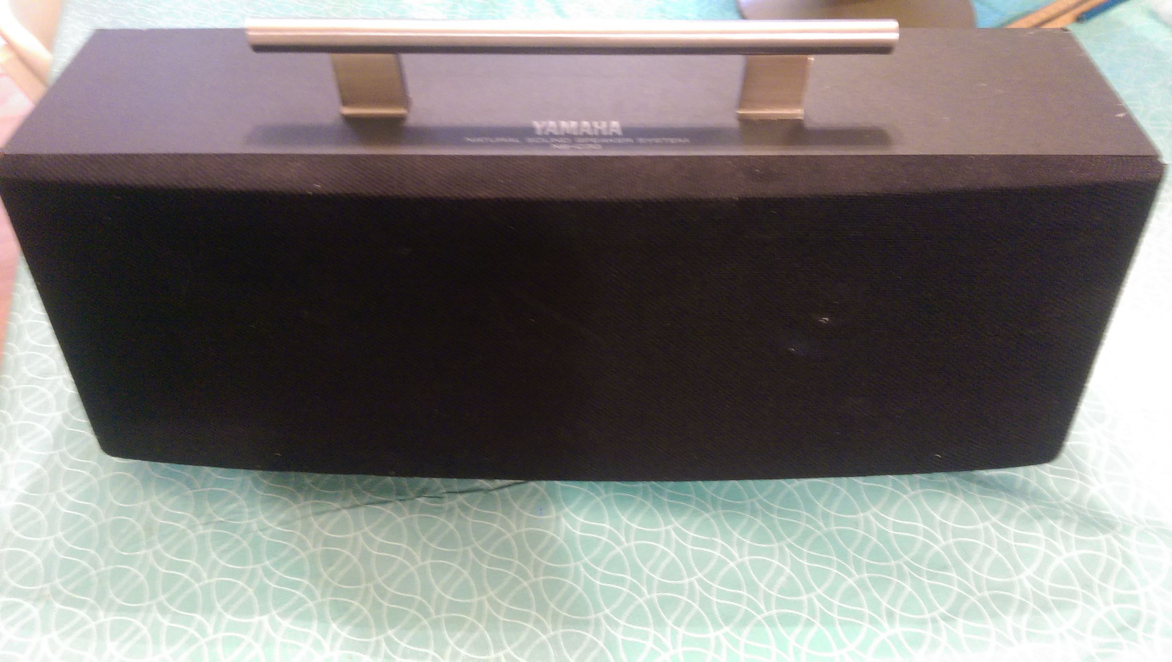

Today I initially intended to just make a Bluetooth speaker from an old surround speaker I had laying around. I wanted a speaker to take to the beach that sounded better than the little inexpensive guys you get. And I didn't want to buy something expensive that I was constantly worried about down there. Anyway, it dawned on me this morning heading down to the beach, instead of hauling both my guitar and speaker down there, why not just throw the speakers in my guitar? lol
