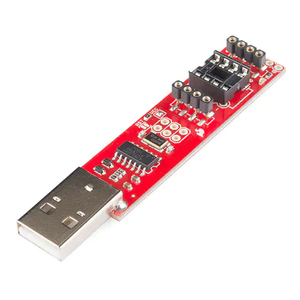

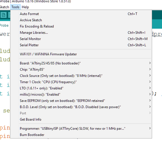

Setup your Arduino environment for ATTiny using one of many online guides. Use the SpenceKonde ATTiny core to do this as described in the guides. Program ATtiny85 using code from Github using your favorite method. You can use an Arduino to do this but I use one of the sparkfun PGM-11801 USB programming boards as shown in the photo. Prior to programming the chip the first time, the fuses for the ATtiny should be configured as shown in the screenshot of the menu drop down from the Arduino IDE by selecting "burn bootloader" from the menu. Plug the programmed ATtiny into socket on board. Verify the board works as expected and recommend measuring the 38KHz nominal output that it produces using a frequency counter or oscilloscope to verify that the frequency is within one kHz or so from the nominal 38KHz.
