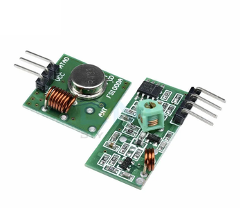

Now let's learn a bit about our RF Tx/Rx pair.
The Tx/Rx pair that is used in this project uses a frequency of 433MHz which falls in the ISM band. ISM stands for Industrial, Scientific, and Medical. This band of frequency is free to use and is unlicensed.
The Tx/Rx pair employs an ASK modulation scheme for transmitting and receiving data. ASK stands for Amplitude shift keying which is one of the digital modulation techniques others being Frequency shift keying (FSK) and Phase shift keying (PSK).

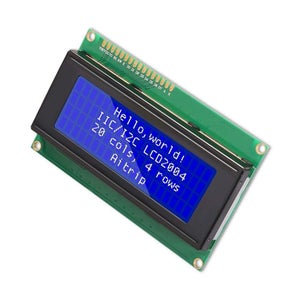

  • LCD 20*4 --->1
  • I2C --->1

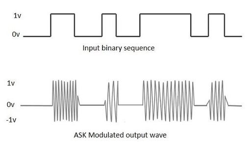

ASK is a type of Amplitude Modulation that represents the binary data in the form of variations in the amplitude of a signal.
Any modulated signal has a high frequency carrier. The binary signal when ASK modulated, gives a zero value for Low input while it gives the carrier output for High input.
The following figure represents ASK modulated waveform along with its input.

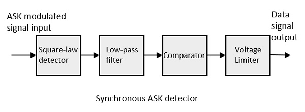

Synchronous ASK Demodulator
Synchronous ASK detector consists of a Square law detector, a low pass filter, a comparator, and a voltage limiter. Following is the block diagram for the same.
The ASK-modulated input signal is given to the Square law detector. A square law detector is one whose output voltage is proportional to the square of the amplitude-modulated input voltage. The low pass filter minimizes the higher frequencies. The comparator and the voltage limiter help to get a clean digital output.

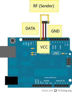

On the RF chip (Transmitter)
  • Device--------> Uno
  • GND D8
  • VCC D9
  • DATA D10

For Coding, first, you need to test the I2C and take the address
you can make that by the following Code and uploading it on the Arduino Nano that connected to LCD
I2C Test

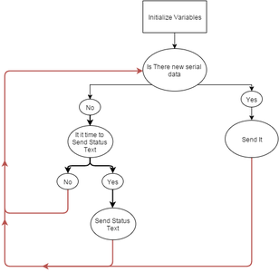

Sender Code
that code will make you able to know whether the I2C is Connected with LCD and the address
then we need to upload the following code to the Arduino Uno, it's so simple you can understand it easily

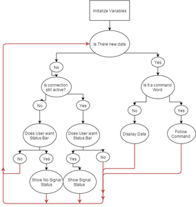

Explain of Receiving Code
Here we go to the hard part
Uploading the Reciever code to the Arduino nano
Include Libraries and define the variables

The rest of the code is if conditions to know whether the upcoming signal is a word to show or a command for LCD

#include <VirtualWire.h>
#include <Wire.h> //IIC Library
#include <LiquidCrystal_I2C.h>//For the screen
#include <elapsedMillis.h>//For the Status
LiquidCrystal_I2C lcd(0x3F,20,4);  // set the parameters
boolean constat=1;//Status Variable 1=On at start, 0=off at start
int line;//Status code moves cursor, variable to store DESIRED line number
boolean splashcleared;//Bool to hold if splash screen has been cleared
String text = " ";//String to hold the text
elapsedMillis packettimer;//The timer for status
#define interval 1500//The threshold for how long it can go without "6"(The connection indicator)
//initialize the symbols
void setup()
  pinMode(12, OUTPUT); //Module VCC
  digitalWrite(12, HIGH);   // turn the VCC to High
  vw_set_rx_pin(11);// set you rx pin
  vw_setup(2500);  // Bits per sec. Lower for further distance. Make sure this matches the number on the transmitter
  vw_rx_start();       // Start the receiver PLL running
  splashcleared=0;//make sure that this is 0
  lcd.init();//start the screen
  //setCursor comands note- Counting starts at 0 NOT 1
  lcd.createChar(0, cchar); //Rf symbol
  lcd.createChar(1, bar1); //Bar 1 and 2
  lcd.createChar(2, bar2); //Bar 3 and 4
  Serial.begin(9600);//Open serial port, add the !serial thing for leonardo
  lcd.backlight();//Turn on the backlight
  lcd.clear();//Clear the screen
  lcd.home();//go home
    //display Home screen This will be cleared once The siglal indicator "6" is sent
  lcd.setCursor (5,0);
  lcd.print("RF--Screen");
  lcd.setCursor (0,1);
  lcd.print("By ICARUS");
  lcd.setCursor (0,2);
  lcd.print("Connection Status-");
  lcd.setCursor (0,3);
  lcd.print("Inactive");
  delay (1200);//set this to the interval
  void loop()
    uint8_t buf[VW_MAX_MESSAGE_LEN];
    uint8_t buflen = VW_MAX_MESSAGE_LEN;
    if (packettimer< interval){//It the status of the connection is good and "6" was recieved in the last 1.5 secs.
      if (splashcleared==0){//if screen hasn't been cleared of status
        lcd.clear();//clear it
        splashcleared=1;//make sure it won't be again
    }//make sure the screen wont clear again
    if (constat==1){  //If the status bar is enabled
        lcd.setCursor (17,0); //go to 3rd last position
        lcd.write(0); //RF symbol
        lcd.write(1);//bar one
        lcd.write(2);//Bar two
      else if (packettimer > interval) {//It the status of the connection is bad and "6" was not recieved in the last 1.5 secs.
        //we will blink a X by the rf symbol
        lcd.setCursor (17,0);//go to 3rd last position
        lcd.setCursor (18,0);//go to 2nd last position
        lcd.print ("X ");//To add the X
        delay (450);// wait
        lcd.setCursor (18,0);////go to 2nd last position
        lcd.print ("  ");//To erase the X
        delay (400);//wait
    if (vw_get_message(buf, &buflen)) // Non-blocking
      packettimer = 0;//Reset timer when data is recieved
      text.remove(0);//clear all text from string: text
      text=(char*)buf;//put new data into string "text"
      text.remove(buflen-1);//Remove garbage after the end of the text
      lcd.setCursor(0,line);//Restore cursor to original position
      //Most of these commands are self explanitory...
      if (text.startsWith("1")) {
        lcd.setCursor(0,0);
        line=0;
      else if (text.startsWith("2")) {
        lcd.setCursor(0,1);
        line=1;
      else if (text.startsWith("3")) {
        lcd.setCursor(0,2);
        line=2;
      else if (text.startsWith("4")) {
        lcd.setCursor(0,3);
        line=3;
      else if (text.startsWith("clear")) {
        lcd.clear();
      else if (text.startsWith("6")) {//"6" is sent every 300 ms to check the signal, and we dont want it to display
          lcd.clear();
          splashcleared=1;//make sure the screen wont clear again
      else if (text.startsWith("backlight")) {
        lcd.backlight();
      else if (text.startsWith("nobacklight")) {
        lcd.noBacklight();
      else if (text.startsWith("status")) {
        lcd.setCursor (17,0);//Go to the third last spot
        lcd.write(0);//Show the Rf symbol
        lcd.write(1);//Show bar set 1
        lcd.write(2);//Show bar set 2
        constat=1;//(ConnectionStatus)this variable will make the signal show
      else if (text.startsWith("nostatus")) {
        lcd.print ("   ");//write it over with 3 spaces
        constat=0;//(ConnectionStatus)this variable will block the signal from showing
      else if (text.startsWith("{")) {//if we want to sen a command word to display on screen, we precede it with{
        text.remove (1); //remove the"{", This must be second last of if statements
      else {//this MUST be last statement
        packettimer = 0;//Reset timer when data is put onto the screen
        lcd.setCursor(0,line);//Go to the specified line
        lcd.print(text);//If word isn't a command print it
