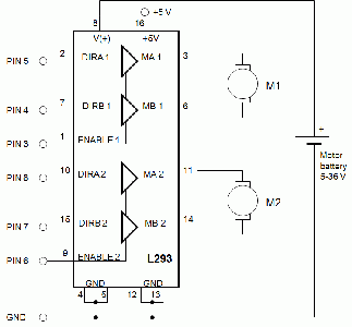

For the controller we will use the ArduRF1s because it is complete and easily fits on a breadboard. The motor controller is an L293D IC. It has two complete H-bridges in the package so we only need one to drive both wheels. We will use the PWM output of the Arduino to control the speed of each wheel so we can steer the buggy.
Plug the ArduRF1s on a small breadboard so that the USB connecter sticks out over the edge of the breadboard. This makes sure there is room for the L293D on the breadboard. Now plug the L293D into the breadboard. Using the breadboard wires, wire the L293D to the ArduRF1s pins according to the schematic on the next page.
Step 5: Wiring the L293D
Follow the diagram closely leaving the motor connections for last. Where it says Pin 5 on the connection diagram, locate the pin marked D5 on the ArduRF1s and connect it to pin number 2 on the L293D. Do the same for all the connections that start with "PIN".
Connect the four ground pins of the L293D to the power strip of the breadboard that has the blue line next to it. Also connect one of the pins on the ArduRF1s marked 'Gnd' to the blue power strip.
Connect pin 16 of the L293D to the pin marked 3.3V on the ArduRF1s. This is the logic power supply of the L293D and we use the 3.3V regulator on the ArduRF1s to power the logic of the L293D.

I put the batteries more or less on top of the wheels prevent the wheels from slipping. I put the breadboard on the open space on the acrylic base and connected the wires from the motors to the L293D. The two positive leads go pins 3 and pin 11 of the L293.
Before I brought the motor leads to the top of the buggy I tied a knot in the wires. The knots prevent you from stressing the connections to the motors. The two negative leads of the motors go to pin 6 and pin 14 of the L293D.
Now that the breadboard is on the buggy you can connect the batteries to the breadboard. Connect the negative terminal of the battery to the blue power strip on the breadboard. Connect the positive lead from the battery holders to the power strip on the breadboard with the red line next to it.
Connect the battery power to pin 8 of the L293D to power the motors from the battery. Everything is now connected.
