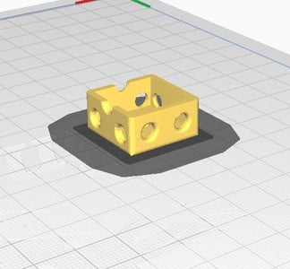

The die is designed on tinkercad and 3D printed using ABS filament. The print time was approximately 45 minutes.

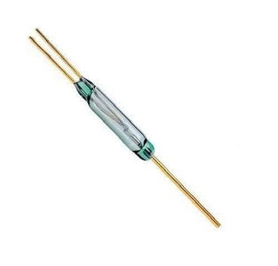

NO/NC Reed Switch

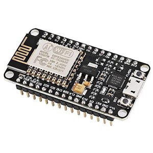

NodeMCU ESP-8266

Step 1: 3D Designing the Die
I have designed the die from scratch on tinkercad but you can also download it from thingsverse.
I have not calculated the probability of getting each number.
3D models
https://www.tinkercad.com/things/4dxnMm4n2IQ
​https://www.thingiverse.com/thing:1688174
Step 2: Programming the ESP-01
Assuming you know how to program esp-01.
Upload the attached code to your esp 01.
After uploading the code it is recommended to remove the header pins of the esp-01 to make it smaller in size.
NOTE: It is not required to replace the mac address here.

We will use a NC Reed Switch to turn on and off the circuit.
