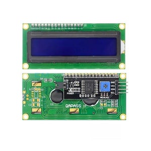

3. 16x2 I2C LCD Module

Arduino to LCD Module
5V --> Vcc
GND --> GND
A4 --> SDA
A5 --> SCL

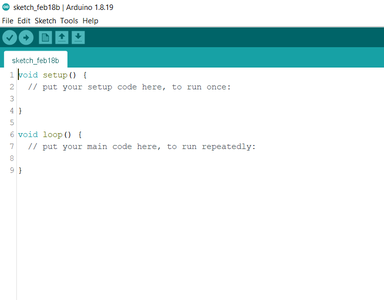

Step 4: Code File
Before uploading the code, make sure that the LiquidCrystal I2C library is installed on your device.
To do that, follow the steps.
1. Open Arduino IDE
2. Go to Sketch --> Include Library --> Manage Libraries
3. Type LiquidCrystal_I2C in the search box and install the one by Marco Schwartz
4. Include library in the code
Then utilise the code file uploaded below
PS: Before uploading the code, disconnect pins 1 and 2 of the Bluetooth module from the Arduino board as it will cause an error while uploading the code.
