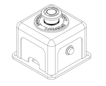

  • WE-PB is designed for all those who need to block the power supply or the passage of a signal by launching a remote command, pressing an emergency button.
  • ​The project consists of 2 stations, RECEIVER (connected to the system to command) and TRANSMITTER (consisting of the portable emergency button).
  • In a short time you can have a simpleintuitive and fun product on your desk!

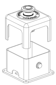

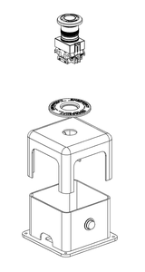

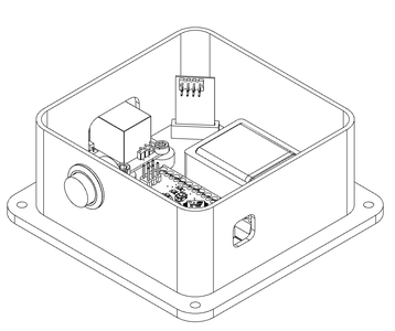

Step 2: Transmitter - Receiver Structure
✅ OFFICIAL WEBSITE: https://www.diy-tech.it/

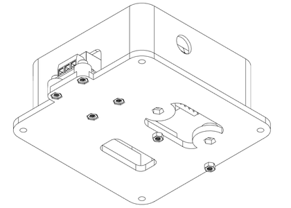

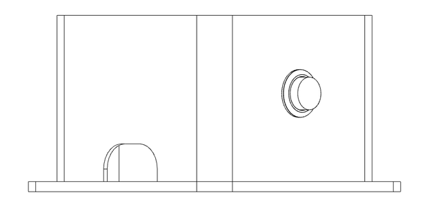

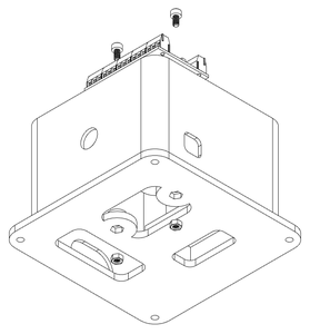

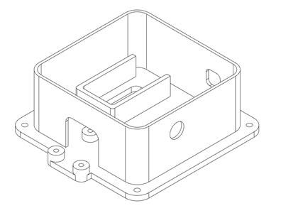

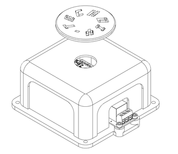

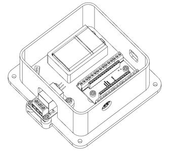

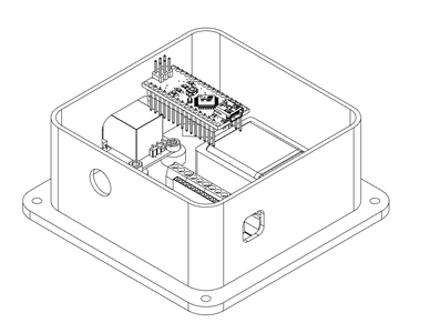

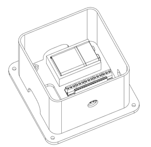

Step 3: Receiver

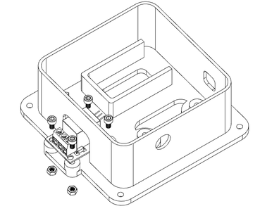

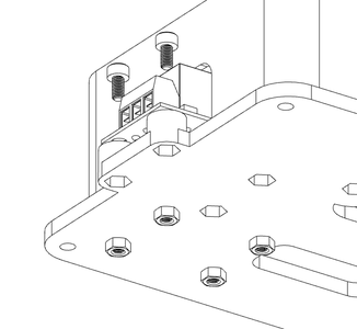

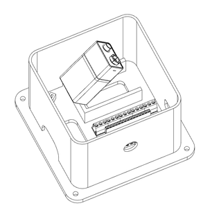

  1. Fix the KY-019 relay module to “CRC-EMG-LAN” using 4 M3X8 screws.
  2. Fix the KY-019 relay module to “CRC-EMG-LAN” using 4 M3 Nuts.

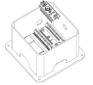

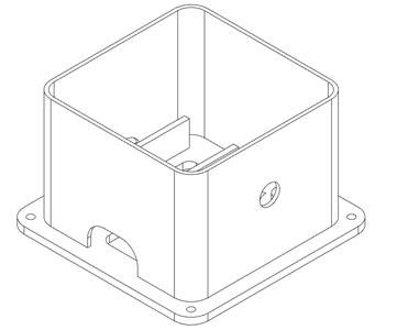

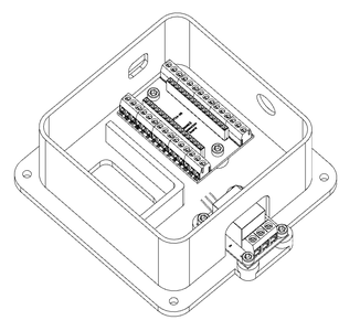

  3. Fix the support for the Arduino NANO board on the space indicated in the figure on the “CRC-EMG-LAN” using 2 M3X8 screws and 2 M3 Nut.

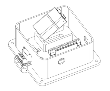

  4. Insert the 9V battery into the aposity slot of the “CRC-EMG-LAN”.

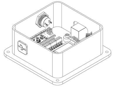

  5. Insert the Arduino board on the appropriate connectors of the support board previously installed on “CRC-EMG-LAN”. Pay attention to the correct direction of the Arduino board on the support board.

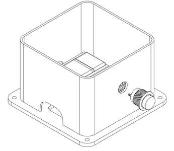

  6. Fix the button inside the hole on the wall of the 3D printed component using the lock nut.
  7. Place the NRF24L01 inside the special cavity as shown in the figure, the pins must be facing the Arduino board.

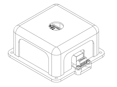

  8. Insert the “TB-EMG-LAN” cap inside the special cavity as shown in the figure.
  9. Place the “COV-EMG-LAN” lid on the “TB-EMG-LAN” without worrying about the direction.
  10. Finally, place the circular plate (“ETC-EMG-LAN”) on the central hole of “COV-EMG-LAN”.

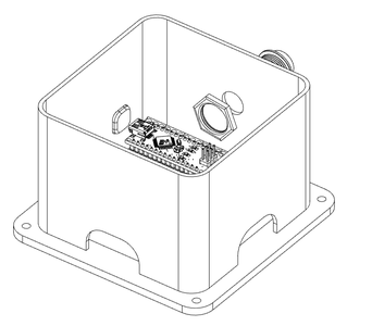

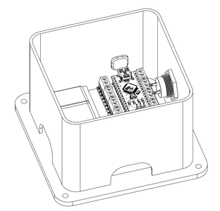

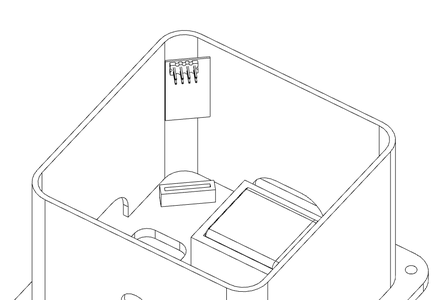

Step 4: Transmitter
  1. Fix the support for the Arduino NANO board on the space indicated in the figure on the “ACT-EMG-LAN” using 2 M3X8 screws.
  2. Complete the fastening of the support to the “ACT-EMG-LAN” with 2 M3 nuts.
  3. Insert the 9V battery into the aposity slot of the “ACT-EMG-LAN”.
  4. Place the NRF24L01 inside the special cavity as shown in the figure, the pins must be facing the Arduino board.
  5. Insert the Arduino board on the appropriate connectors of the support board previously installed on “ACT-EMG-LAN”. Pay attention to the correct direction of the Arduino board on the support board.
  6. Insert the “TB-EMG-LAN” cap inside the special cavity as shown in the figure.
  7. Fix the button inside the hole on the wall of the 3D printed component using the lock nut.
  8. Fix the emergency button to the “CVB-EMG-LAN” by installing the button itself inside the appropriate hole. Then place the “CVB-EMG-LAN” on the “ACT-EMG-LAN” as shown in the figure.

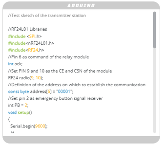

Step 6: Software
The software to download for the Arduino boards can be downloaded from the official page of the project: https://www.diy-tech.it/020-wepb
