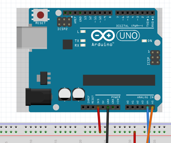

Step 2: 2. Design of the Circuit (Master and Slave)
In this project, you will have a Master Node and a Slave Node.
The master node will print the data send by the slave node in clear. It will request data from the slave node every X time.
The slave node will listen the "network" and when it receive a "Request data", it will generate it, encrypt it and send it to the master node.
For both side, master and slave the circuit are the same :
- One arduino Nano
- One ATECC608A
- One NRF24L01
I attached the circuit to this step (cf picture above).
For the ATECC608A to the Arduino UNO, this is a soic 8 pin . I added the "top view" above :
- ARDUINO 3.3V -> PIN 8 (Atecc608a)
- ARDUINO GND -> PIN 4 (Atecc608a)
- ARDUINO A4 (SDL) -> PIN 5 (Atecc608a)
- ARDUINO A5 (SCL) -> PIN 6 (Atecc608a)
For the NRF24L01 to the Arduino :
- ARDUINO 3.3V -> VCC (nrf24l01)
- ARDUINO GND -> GND (nrf24l01)
- ARDUINO 9 -> CE (nrf24l01)
- ARDUINO 10 -> CSN (nrf24l01)
- ARDUINO 11 -> MOSI (nrf24L01)
- ARDUINO 12 -> MISO (nrf24l01)
- ARDUINO 13 -> SCK (nrf24l01)
- ARDUINO 3 -> IRQ (nrf24l01) -> only for Slave node, not used in Master mode
