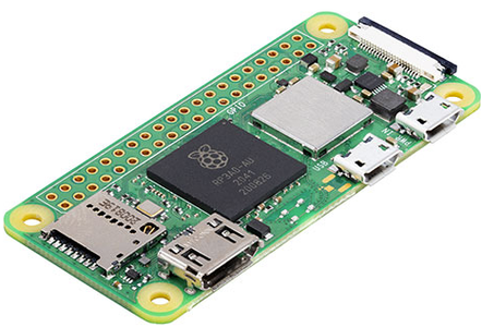

  1. The core of the Rover station is the Raspberry Pi Zero 2 W. Users can develop their own applications for the setup or simply forward the location data via a Bluetooth link to a mobile phone. For instance, they can use an exceptionally powerful free app called SW Maps, which is available on both the Android and Apple app stores.

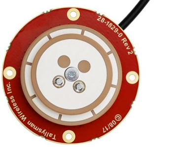

  2. 2 x Tallysman TW1889 GNSS antenna

  6. 1 x Raspberry Pi Zero2 W mini computer

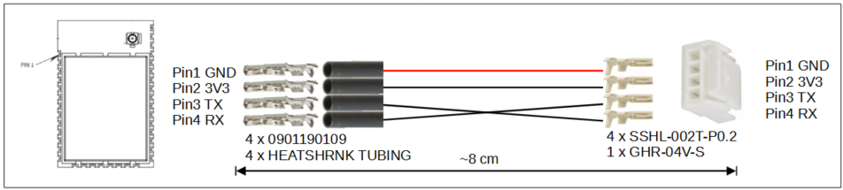

  4. 2 x XBEE signal&power cable: GHS 4pin to 2.54'' pin header 4pin

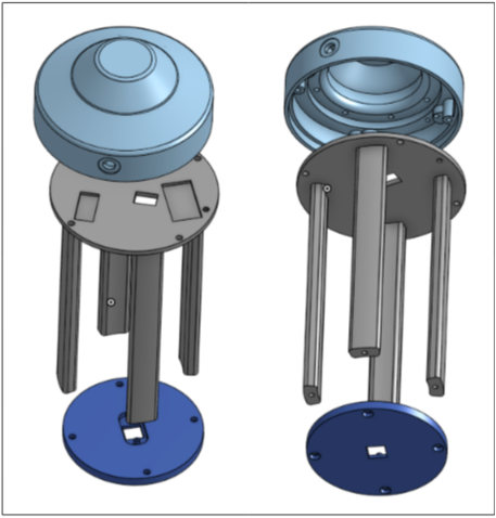

  8. 2 x mech 3D printed parts: mech assembly parts and screws

  9. XBEE Connector:
  10. The wireless communication link module connects to the XBEE connector
  11. By default, the transmitter model is XBEE 863 (EU), but XBEE 900 (US) is also supported without additional effort.
  12. Other types of radio modules can be used if they support AT protocol serial communication.

Step 2: Raspberry Pi Zero2 W Configuration
Before assembling the Raspberry Pi Zero 2 W mini computer into the Rover, it must first be pre-configured.
Complete the following steps for Raspberry:

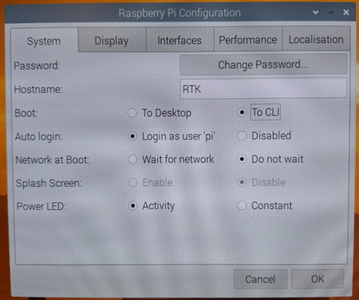

  2. Rename 'Hostname', Auto login as pi, boot 'To CLI', 'Do not wait' Network at Boot (see the pic)

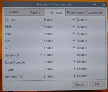

  3. Enable Serial Port (see the pic)

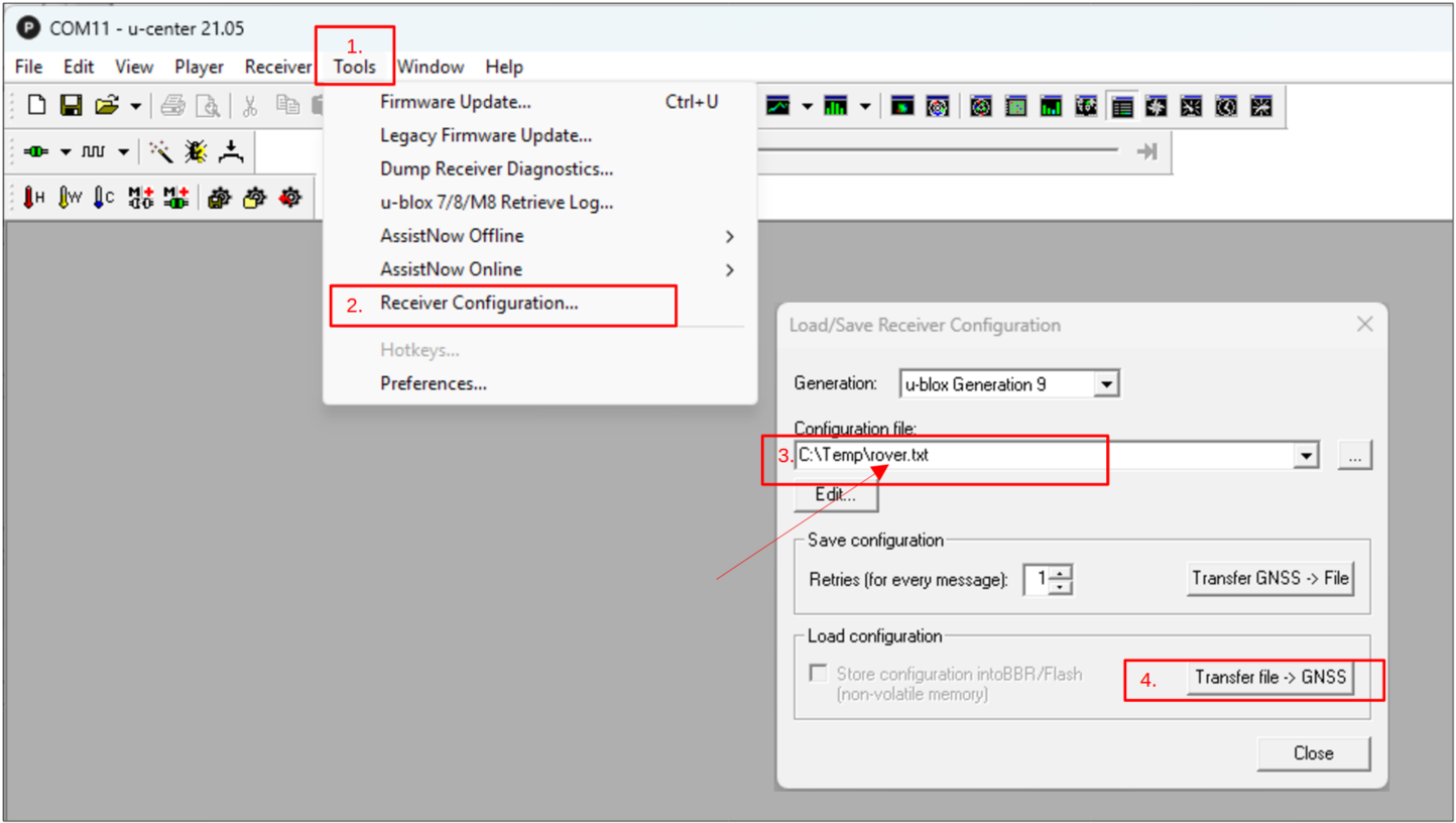

Step 3: GNSS RTK Module Pre-Configurations
The ZED-F9P GNSS Datasheet can be found here:: ZED-F9P-05B_Datasheet
To begin, install the GNSS Evaluation Software for Windows, u-center, on your PC.
Before the GNSS modules can be utilized, they must be pre-configured. Note that the pre-configurations for the Base and Rover GNSS modules are different. All necessary configurations have been provided in the attached files, and it is sufficient to load them directly from these files.
1) Pre-configure the GNSS module of Base station:
Power on the main board of the Base station by connecting it to a power bank. Attach the U-blox debug cable to the U-blox connector (refer to Step 5 for details about the debug cable).
Launch the u-center tool and proceed with the following steps:
The Base station transmits the following RTCM MSM4 messages to the Rover station: 1005, 1074, 1084, 1094, 1124, and 1230. If additional messages need to be sent, the XBEE settings must be adjusted to increase both data bandwidth and data rate.
2) Pre-configure the GNSS module of Rover station:

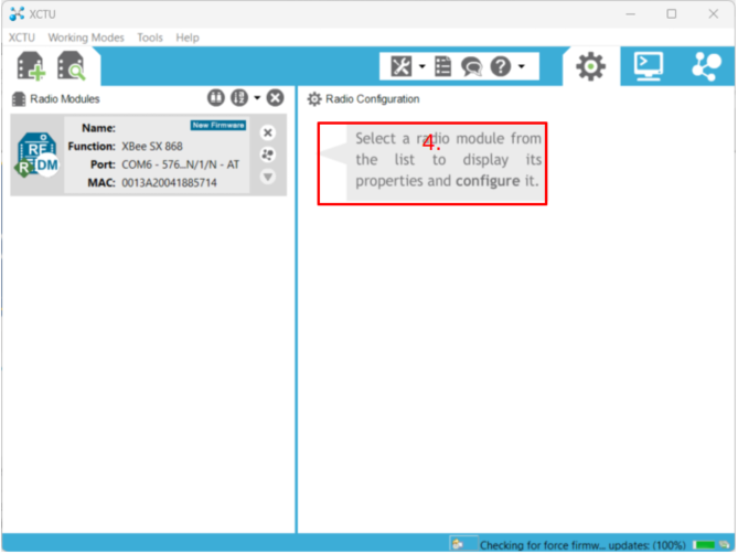

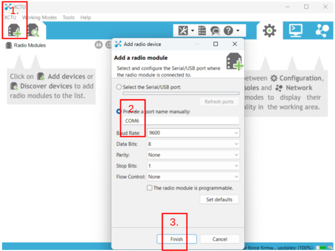

Step 4: XBEE Module Configuration
The XBee® SX 868 RF Module User Guide contains the datasheet for the XBEE transmitter. XBee® SX 868 RF Module User Guide.
To get started, install the Configuration Platform Tool, XCTU, on your PC.
Before assembling the transmitters into the sets, they must be pre-configured. The pre-configurations are the same for both the Base and Rover stations.
Take the first XBEE module and connect it to your PC using a USB-UART debug cable. Various USB-UART cables are available on the market; you may use your preferred model, but ensure that the output voltage of the cable is 3.3V. Connect the following signals to the XBEE module: GND, 3V3, RX, and TX. For more details about the USB-UART debug cable, refer to Step 5.
Launch the XCTU tool and proceed with the following steps:
Open Radio Configuration list by clicking the Radio Module.
Make the following changes and ensure to save (write) them to the Radio Module.
Now that the first Radio module has been pre-configured, repeat the same procedure for the second Radio module. Once configured, no further re-configuration of the radios will be necessary.
Step 5: Mechanics
The main parts are:
1) Main board
  1. The board size 30 x 65 mm
  2. Four layers PCB stack-up
  3. All components in one side
  4. The main PCB design is not published. You have to do your own design.

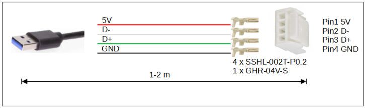

2) Main power cable: GHS 2pin to USB type A
  1. Reworked from a standard USB type A cable
3) Raspberry signal & power cable: GHS 8pin to pin header 8pin
4) u-blox debug cable: GHS 4pin to USB type A
5) XBEE signal & power cable: GHS 4pin to pin header 4pin
6) XBEE 3V3 debug cable: e.g. TTL-232RG-VSW3V3-WE
7) PCB Ground plane for GNSS antennas
  1. The minimum required size of the ground plane is 70 mm in diameter.
  2. The distance between the antenna and the ground plane is 10mm.

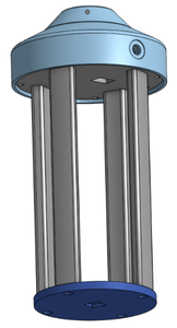

8) Mech 3D printed parts: mech assembly parts and screws
  1. All electronic components have been assembled inside the top hat.

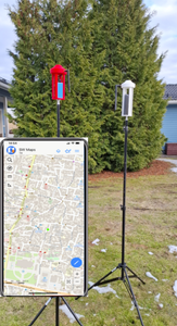

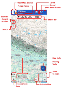

Step 6: SW Maps Configuration

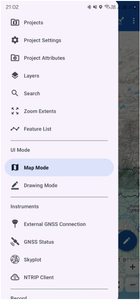

Finally, once all the parts have been configured, assembled, and powered on, follow these steps to configure your mobile phone:
  1. Install SW Maps mobile mapping app on your mobile phone
  2. Refer to the User Manual using the provided web link
  3. Enable Bluetooth in your mobile phone's settings
  4. Pair your mobile's Bluetooth with the Rover
  5. Open SW maps app
  6. Tap the Main Drawer in the top-left corner
  7. Select External GNSS Connection and establish a Bluetooth connection to the Rover
  8. Switch to the Skyplot view
  9. Enjoy centimeter-level location accuracy!

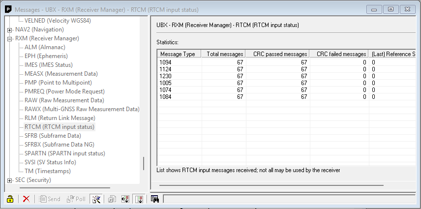

Debugging with the U-blox Debug Cable
  1. If DGPS or higher states are not achieved, it is possible that the Rover is not receiving correction data from the Base Station.
  2. Connect the U-blox debug cable to the U-blox connector on the Rover's main board.
  3. Launch the u-center tool and establish a communication link via the appropriate COM port (COMx).
  4. Open the Messages View in u-center and navigate to the list of messages:
  5. Go to UBX → RXM (Receiver Manager) → RTCM (RTCM Input Status).
  6. Right-click the top of the RTCM line and enable Input Status Reporting.
  7. Once enabled, you will see a list of Message Types displayed on the right-hand side. Refer to the example image below.
  8. If no messages appear, it likely indicates that the radio link between the Base Station and Rover is not functioning.
The most critical message type is 1005, but additional messages (greater than 2) should also be listed.
