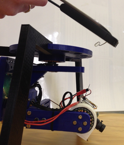

Gimbal Assembly:
· The gimbal frame should be as rigid as possible to avoid any delayed fluctuations or movements reaching either of the IMU sensors (if two are used).
· The gimbal should be balanced properly on all axis with the payload attached. Make sure that the gimbal controller (frame IMU) and camera/payload IMU is mounted correctly.

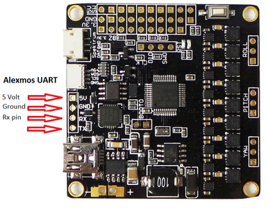

· The Arduino microcontroller with the Wi-Fi shield attached needs to be mounted on the gimbal below-yaw (as shown in the picture above) in such a way that it can be connected to the Alexmos gimbal controller via UART.
· The Arduino and its Wi-Fi shield can be powered from the UART’s 5V/Ground lines coming from the gimbal controller. The gimbal controller receives power from the 3 cell Li-Po battery.
· The UART port should be labelled on the gimbal controller (it is also referred to as the “Serial Bluetooth Port”). A single signal line (normal conductive wire) connects the Arduino’s transmitting (Tx) UART pin to the Alexmos board’s receiving (Rx) UART pin. Communication only takes place one-way, since the Arduino sends the gimbal controller commands on how to orientate itself, but does not receive anything in return.
· The Arduino’s UART Tx pin number can be specified, since it is a software serial port (the Wi-Fi shield already uses the hardware serial ports). The pin number is specified in the SBGC Serial API library header file (further discussed in step 4). The default pin number when the Arduino Mega is being used is Pin 49 (this will need to be changed when using the Uno, since it does not have that many pins).

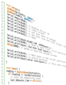

Step 4: Software Setup - Arduino
Once all the software packages are installed, the code can be opened and uploaded using each respective IDE.
Copy the MyGimbalControl.ino file and it's containing folder into your PC’s Arduino project directory (you should have downloaded it from G-Drive in Step 2), and open it using the Arduino IDE. Make sure the “SBGC_Arduino” and “SBGC_lib” library files are both in the library folder in the Arduino directory. Next, make sure the Arduino is connect via USB. If an Arduino Mega is being used, the code can be uploaded as is. (If you get an upload error, check that the correct Arduino Device is selected in “Tools”, as well as the correct port).
If an Arduino Uno is being used, the UART Tx pin needs to be changed to one that is available on the Uno. To change it, open the SBGC_Arduino.h file in the “SBGC_Arduino” Arduino library folder (use notepad or wordpad to open). The very first line of code is “#define SBGCTx 49,” to change the UART Tx pin on the Arduino Uno, change the number to the available pin that connects to the UART Rx pin on the gimbal controller. Upload the code to the Arduino.
Once a program is uploaded on to the Arduino, it will stay there unless erased or changed, even when power is removed.

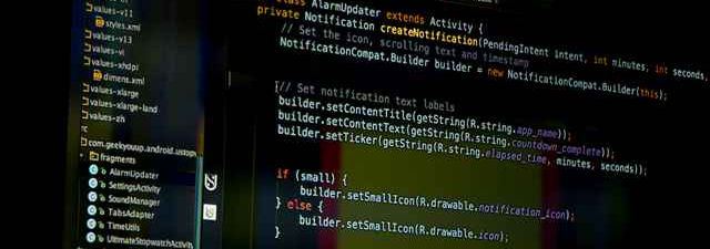

Step 5: Software Setup - Android Code
Open Android Studio and import the ControlGimbal project folder (you should have downloaded it in Step 2).
- Android Studio looks quite overwhelming for an IDE, but it is quite simple once you get to know it. Fortunately for this application it is only necessary to upload the code on to the Google Glass. Once project folder has been imported, connect Google Glass to your computer via its micro USB port.
- Each Wi-Fi shield has a default IP address, it is necessary to change the IP address of the Arduino Wi-Fi shield in the code in Android Studio. To do this, navigate in the toolbar on the left to the following file: app/java/josuablom.controlgimbal/SensorActivity. Double click on SensorActivity, the first line of code declares the string variable “SERVERIP,” change its value (the IP address in green) to the IP address of the current Arduino Wi-Fi shield being used. Save the code (Ctrl + S). Finding the Arduino Wi-Fi shield’s IP address will be discussed in Step 6, so keep Android Studio open for now and continue.
- Once the Google Glass is connect, click the green play button on the top toolbar, or use the keyboard shortcut (shift + F10). This should upload the application on to Google Glass, wait a moment until it is finished uploading. At this point, disconnect Google Glass from the computer, the Control Gimbal application home screen should be visible on the Google Glass, if not, navigate to the application.
