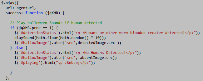

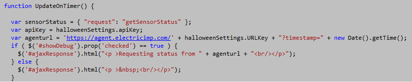

The Javascript code periodically request the PIR sensor status from the imp. When the PIR has detected motion, the client code generates a random number which is an index into an array of sound effects. On mobile devices, the sounds are not loaded to conserve your mobile data pan so a user interface element is required to start them loading. The "Press to start" button initiates the loading of all the sound effects and is then hidden. This also initiates the polling cycle for ajax calls to the imp agent for PIR sensor status. The sounds that I used are all public domain and were found on soundbible.com. There are many public domain sites out there and you don't have to restrict yourself to 10 sound effects.... use as many as you need!
The polling cycle formats a JSON request for the Imp Agent. The URL includes a timestamp to prevent the browser from caching the outgoing request.
The response from the Imp Agent is the status of the PIR sensor. If the sensor status is "1" then a random number is generated to index into the sound table.
