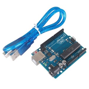

2 x Arduino Uno
IEIK UNO R3 Board ATmega328P with USB Cable for Arduino -
Compatible With Arduino UNO R3 Mega 2560 Nano Robot
http://smile.amazon.com/gp/product/B00P2FX9WY/ref=...
Some other Arduino versions may work but I couldn't get the communication to work with the Mega

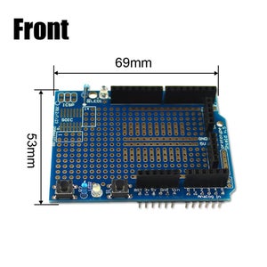

2 x Zitrades Prototyping Prototype Shield + Mini Breadboard +
Free Jumper Cable for Arduino UNO Maga Nano DUE Robot
http://smile.amazon.com/gp/product/B00INLIQ2W/ref=...
Not necessary but the mini breadboard it comes with is excellent for wiring this up

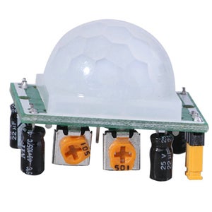

2 x 2013newestseller New 5 X HC-SR501 Adjust Ir Pyroelectric
Infrared PIR Motion Sensor Detector Modules
http://smile.amazon.com/gp/product/B00FDPO9B8/ref=...

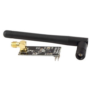

2 x NRF24L01 + 2.4G Wireless Transceiver Module + SMA Antenna
MCU Arduino

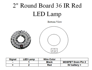

1 x 2" Round Board 36 IR Red LED Lamp for CCTV Security
Camera
http://smile.amazon.com/gp/product/B0056XFS5S/ref=...
1 x CCTV CCD Camera LED Board Single Head 2 Pin Connector Power
Cable 5pcs
http://smile.amazon.com/gp/product/B007PQ0V6A/ref=...
These go with the IR Red LED lamp above

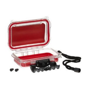

2 x Plano Guide Series 3449 Size Polycarbonate Field Box

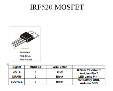

1 x IRF 520 MOSFET

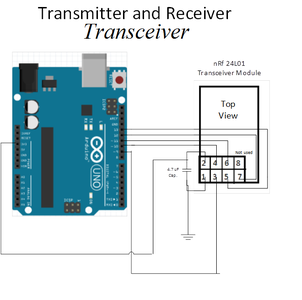

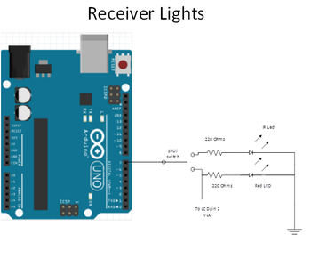

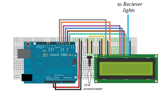

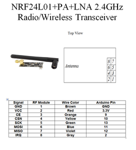

Step 2: Wire the Receiver
Use the pictures to wire the Receiver lights, LCD display, and transceiver.
Important! The Transceiver VCC pin connects to 3.3V. NOT 5V!
Resources:
LCD display
http://arduino.cc/en/Tutorial/LiquidCrystal
http://fritzing.org/projects/how-to-connect-a-qy-1...
although the wiring is a little different for this project

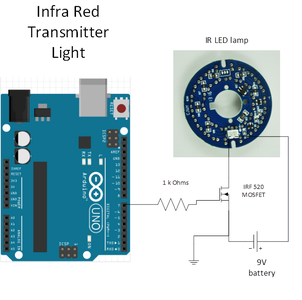

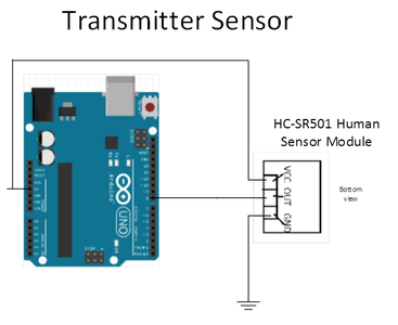

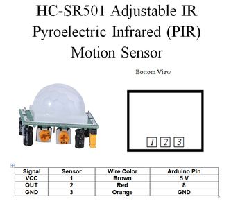

Step 3: Wire the Transmitter
Use the pictures to wire the IR lights, Sensor, and Transceiver.
Resources:
nRF24L01 Information
Sensor Information
http://playground.arduino.cc/Code/PIRsense
the pins will be different but a good resource to test the sensor

Step 6: Housing the Components
I used water proof cases and drilled holes for the power source and antenna. On the Receiver I mounted the switch on the outside although this is not necessary. I hot glued the pieces in place.
