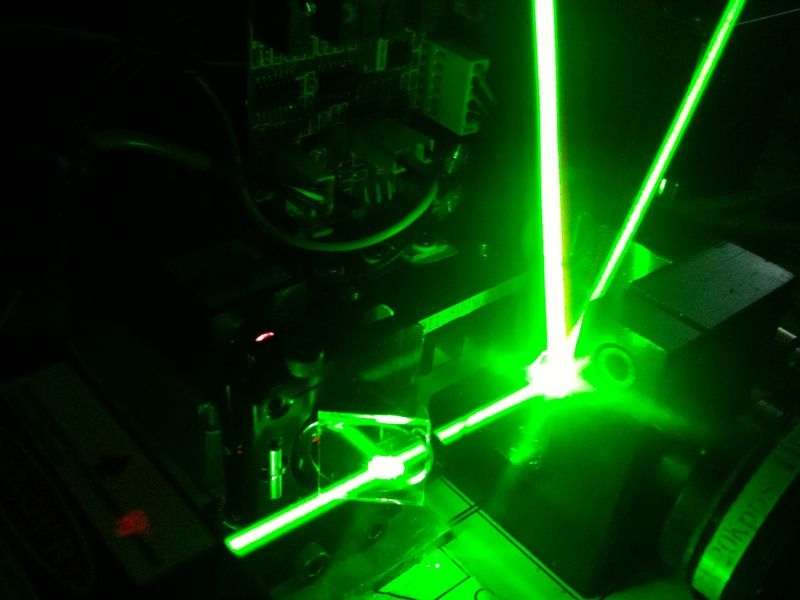

Introduction: Wireless Laser Harp
The Concept:
Build a completely wireless laser harp generator controller using cheap marketplace modules
The system: A standard laser harp system contains: a laser harp generator connected to a projector with ilda connection, a wired footswitch for basic operations, a wired sensor to detect hands on beams, a wired connection with a keyboard or synth module or PC ( called MIDI or MIDI-USB).
The goal is to get rid of wires when possible: we start from the Footswitch. Let's cut the wire!
