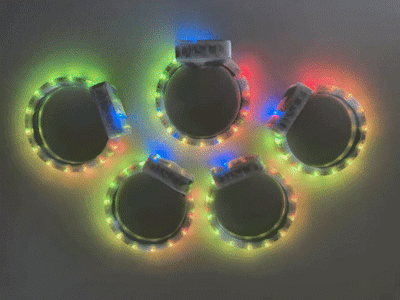

Introduction: Wireless Mesh LED Party Bracelets
I was watching the Glastonbury festival and saw the synchronized LED bracelets that people were wearing in the crowd. So I thought to myself it might be fun to create something similar. This instructable will walk you through how to create your own LED bracelets that will automatically sync together over a MESH wireless network. I've currently made five bracelets and they seem to work flawlessly.

Step 1: Printing the Bracelet
The bracelet fits all the components and prints in one piece. I used a clear TPU but you might choose to use a coloured version. The perforations around the middle can be separated with your thumb or a tool such as a screwdriver allowing you to insert the components once assembled.
The print uses about 17g of filament and takes about two hours. You can view it on Tinkercad or Thingiverse
They are sized to be the smallest I could get my hand through, you may want to scale them up or down in your slicer.

Step 4: Putting It Together
Insert the LEDs first making sure that the LEDs themselves face outwards of course. You must also remember to insert them the same way as you make multiple bracelets.
You should adjust them once in place so that they are all as even as possible.
Then insert the Wemos and try and ensure it is at the back and to one side of the container. The converter goes in next alongside the Wemos and towards the back.
This should have left enough space to get the battery in on top. You can connect the battery and should be able to insert the cables into the gap that is left.
Step 5: Using the Bracelets
When you connect the battery the first bracelet shows a default pattern. As other bracelets are powered up or come within range they should start to automatically sync. This normally only takes a few seconds but sometimes can be longer. If it still hasn't synced after a few minutes, which is very rare, I tend to use the tried and trusted technique of disconnecting and then reconnecting the battery.
With a 400mah battery, I get approximately two hours of use from a bracelet.
