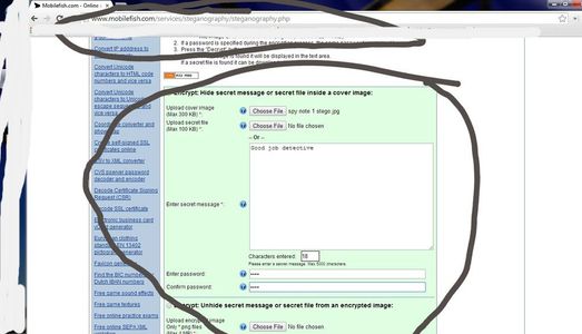

Step 3: Make File Hidden Inside a Plain Photo.
Go to mobilefish.com/services/steganography/steganography.php
Follow the instructions to encrypt secret message or file inside any plain image (.PNG or .jpg) make sure to write down the pin your entered!
Then download that file onto your device.

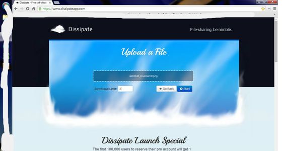

Step 4: Upload Photo to Dissipate
Go to dissipateapp.com and upload the steganographic photo. You can even set to file to expire after being viewed a selected number of times. (Like Snapchat, but for files.) Make sure you write down the URL it gives you!

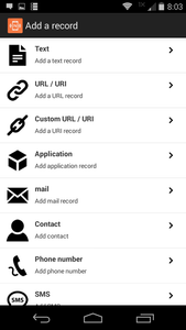

Step 5: Write URL to NFC Card
In the NFC Tools app, select "write" then go to "add record" then select "URL" then pasted the URL you were given by dissipateapp.com for your secret message. Make sure you don't enter the "http://" part in, that is already assumed by the app. Then select "OK" then select "write" then follow the prompt to touch Android device near NFC card. It should say "write successful"!
