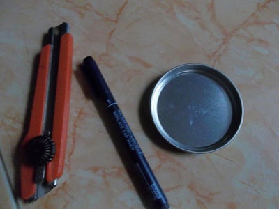

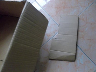

Step 2: Make the Case

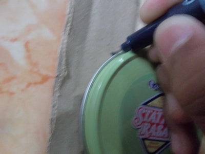

Take the jar lid, place it in the cardboard and mark it using the pen. After that, cut the circle using the cutter.

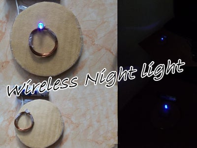

Step 3: Make the Receiver
Take a circle object, and start winding 20 turn of the copper wire and its look like image 2. After that, burn the 2 ends of the copper wire using lighter and solder the ends to the led.

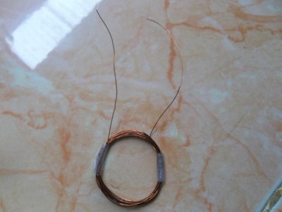

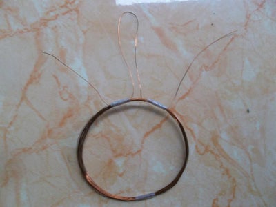

Step 4: Make the Transmitter

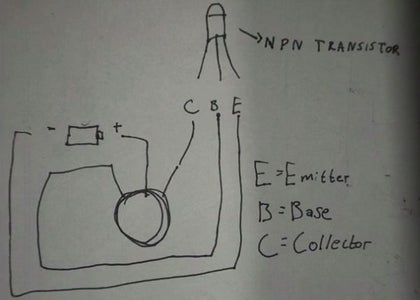

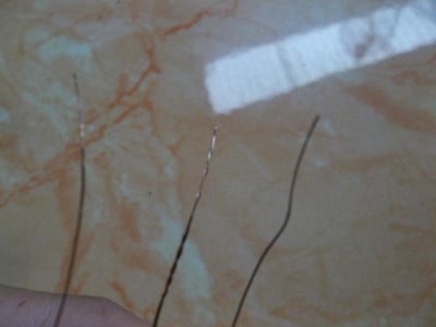

  • Take again the circle object and wind the copper wire (20 turn + 20 turn ). so the output from the coils is 3 output like image 1 and 2
  • Now solder the circuit like image 3

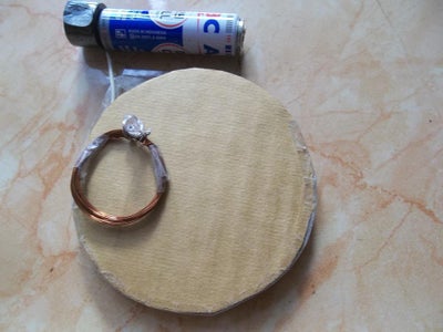

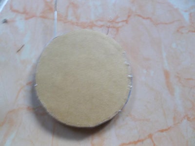

Step 5: Insert the Circuit to the Case
Take the 2 circle cardboard, insert the transmitter into the cardboard, and reinforced it using the clear tape like image

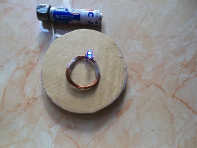

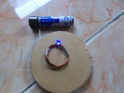

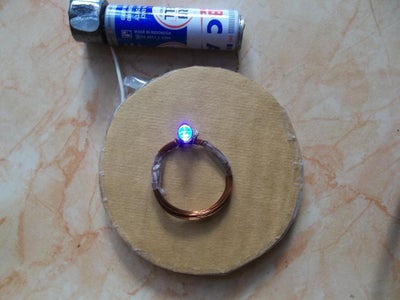

Test:
  1. Connect the transmitter to the AA / 1,5 volt battery (i use magnet to connect the wire into the battery)
  2. Place the receiver on the middle of the transmitter

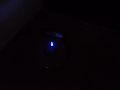

  3. and voila the led is turn on
  4. And test it on the dark place
