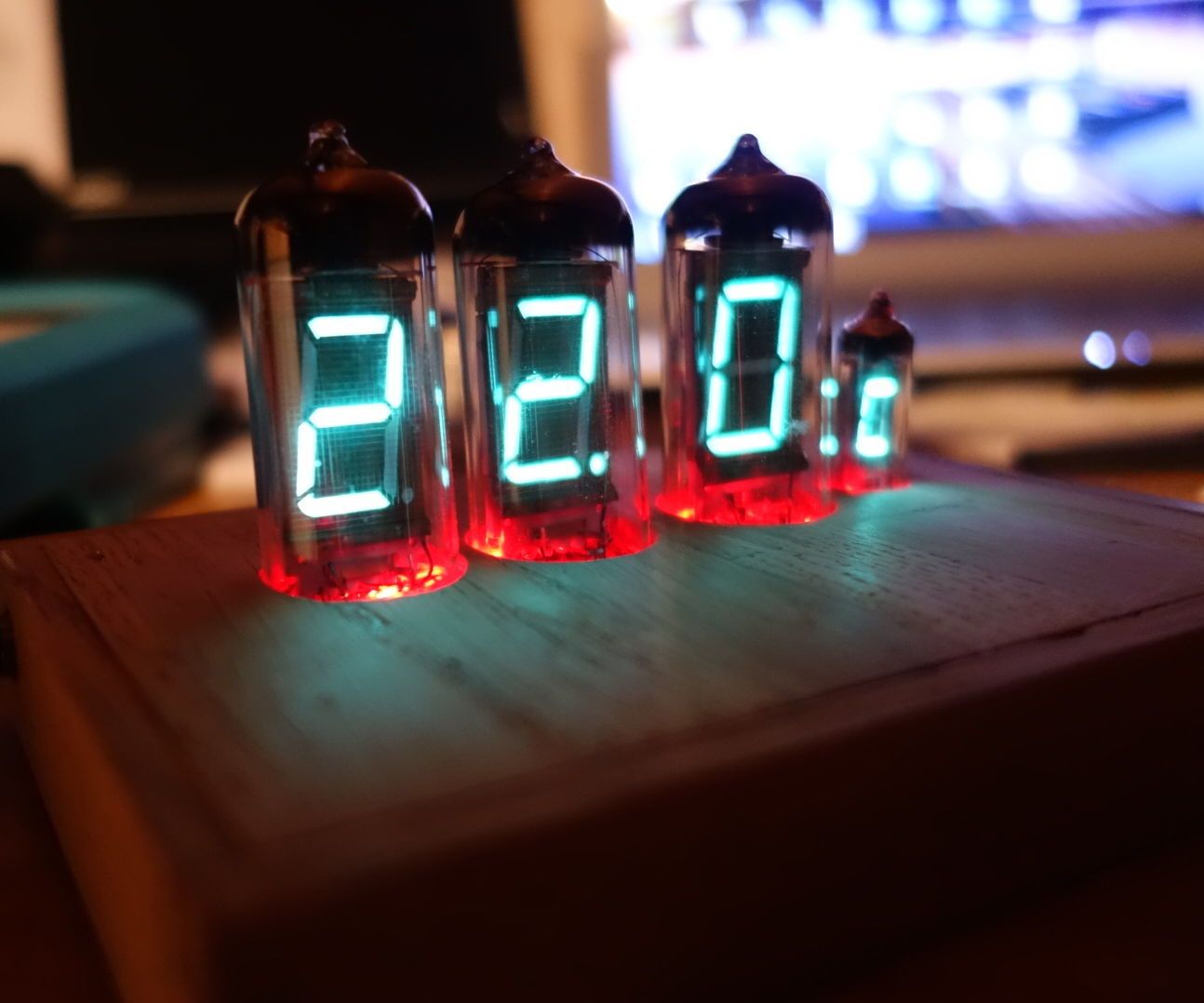

Introduction: Wireless Nixie Thermometer
The Target of this Project was to learn how to use different functions of the atmega:
• Connecting two Atmegas with a wireless connection
• Each Atmega has a Thermometer (DS1621) to read the actual temperature
• Use the sleep Mode of an Atmega
• Controlling a Nixie bargraph In-13
And this all together is a nice looking self-made Thermometer. :)

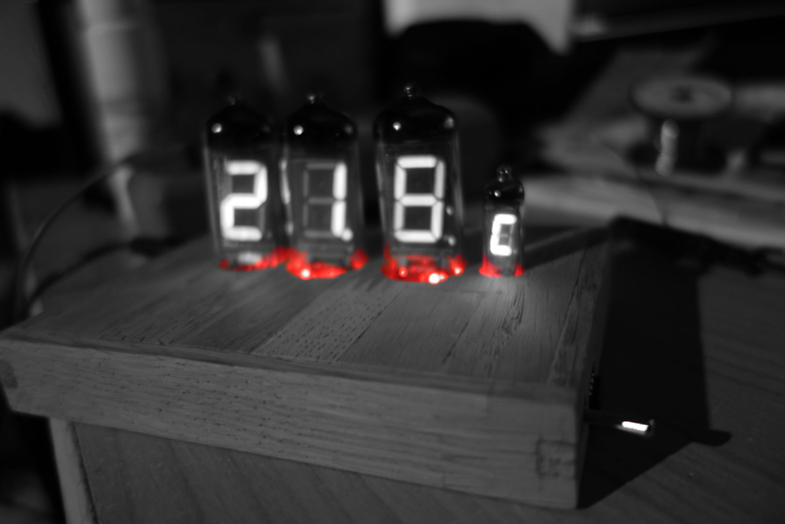

Step 7: Bring It All Together
At this step I solderd all parts into the platine and made some function-Tests.
Here I hat do adjust the bargaphs that they show the correct values.

Step 9: Finishing
At the end I put everythin into a wood-case.
After some tests I recognize that the temperature of DS1621 was influenced by the heat of the nixies. My solution was to bring the sensor to the outside and make a heatsink at the top of it.
