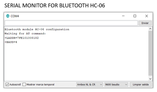

AT+LADDR
It lets you get the MAC address, jot down the value in paper. I my case a got 7FE101008182.
AT+BAUD
It lets you get the baud rate. In case the result is not 4, type AT+BAUD=4 and check that it is finally 4.

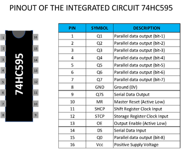

Option 2: With 74HC595
We use 5 pins of the Arduino to control the leds instead of 8 and we also let available the pin 7QS for future implementations such as adding more leds. It is important to bear in mind upcoming designs although in this case we do not need pin 7QS.
If we compare with the option 1, we tell apart the sketch is a bit simpler and we will require less ins of the Arduino but the wiring is a bit more complicated. We also use the control structure SWITCH..CASE but just one in order to put into the 74 HC595 as many ones or high levels as it is indicated in the data. We have previously reset the content of the register in 74HC595. As you can also see, the DS pin is high level all the time, we play with MR pin.

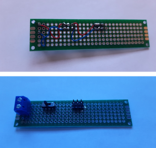

Step 7: Step 3. Wiring
It is time to wire all the components. Take your time and be patient, I suggest you using the polymeter to ensure that the different elements are well-soldered. Please, do not forget to solder all the grounds.
After soldering the different elements, we will cover the circuit side with cello tape in order to avoid shortcuts. and connect the pins.
NOTE: I have soldered it with the integrated circuit 74HC595
