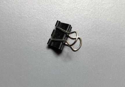

Take a paper clip and hold the reset button on the Bluetooth module with this clip.
The LED will start blinking slowly, indicating AT mode.
