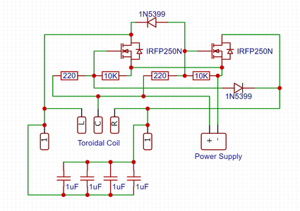

Step 5: Schematics and PCB Design
The schematics of PCBs can be seen above.
Step 6: Circuit Connection – Step 1
To make this wireless power transmission circuit, 1st we connect one mosfet “source” leg with another mosfet “source” leg. Then we make a parallel connection in these Metallized Polypropylene Film Capacitor.
Now we connect both 220 Ω resistor one side terminal with toroidal coil, and then connect it’s other two terminal with “Gate” leg of mosfet.
Then we connect rectifier diode with the circuit. We connect rectifier diode negative terminal with “Drain” leg of mosfet and rectifier diode positive terminal with “Gate” leg of mosfet. We follow the same method connection for another rectifier diode also.
We utilize JLCPCB https://jlcpcb.com/RTA to printout our PCB.
Step 7: Circuit Connection – Step 2
To make this circuit, we used a hand made toroidal coil. It’s have three terminal. Two side have (zero) 0 turns and 1 side have 80 turns. We connect it’s 0 (zero) turns terminal with both mosfet “Drain” leg and it’s 80 turns leg with 220Ω resistor.
Now we connect 10K resistor with the circuit. We connect this two resistor with both mosfet “Gate” and “Source” leg.
Step 8: Circuit Connection – Step 3
For wireless transmission, now we make a coil. Copper wire gauge would be 47mm and there would be 6 turns. We connect this coil two terminal with two mosfet “Drain” leg.
Now we just need to connect DC-12v power supply circuit. We connect its positive leg with toroidal coil 80 turns socket and it’s negative leg with “Source” leg of mosfet.
