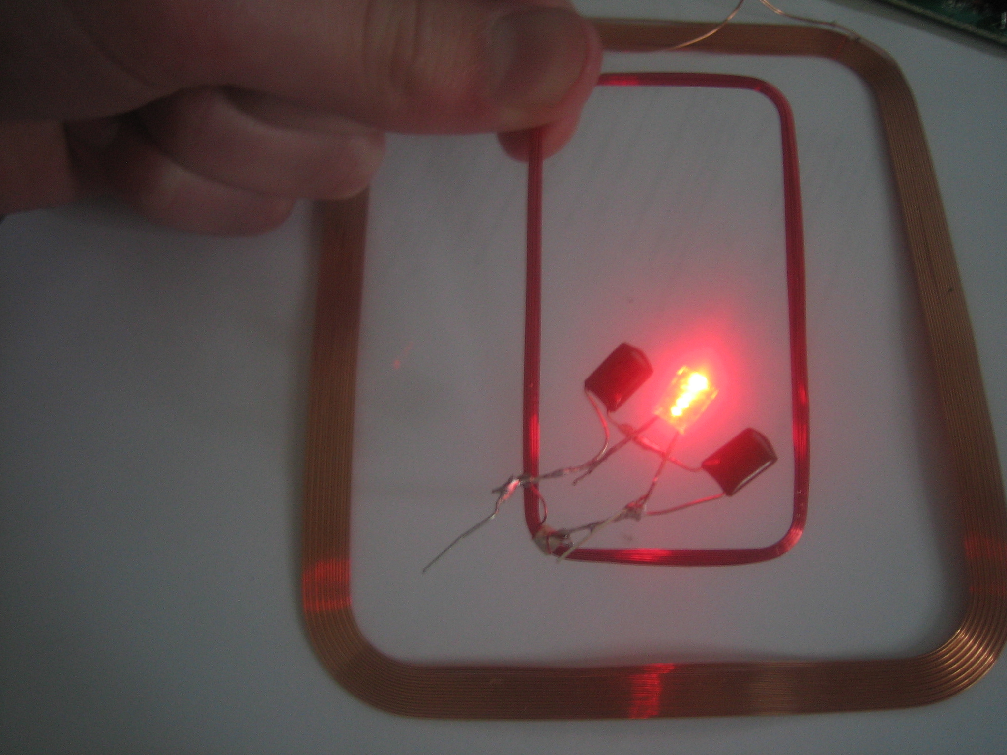

By using a pencil or nails on a 2 x4 and your magnet wire, you can make a pretty good coil. I did about 30-40 turns, depending on the thickness of your magnet wire. Magnet wire has a very thin coating on the top of it. To get this off you can light a match and put the magnet wire in the flame for a few seconds. Take the two ends of you coil and put it into the function generator on the top two screw terminals, one in each terminal. Polarity is not a problem right now because the signal will be AC. Now place your 0.02 uF film capacitor in parallel with the terminals you put the wire magnet ends into. Turn the function generator on and use your multimetter to get it to somewhere near 147-149 kHz by turning the potentiometers. Make sure the switch on the left of the board is set to square, and your good to go. The top to terminals will allow for an AC signal.
Step 3: The Secondary Coil
This circuit is one of the simplest you can ever create. It is composed of magnet wire coil but smaller like the primary, a 0.02uF
capacitor also like the primary, and some leads you can attach things to. For LED's the circuit looks like that. Yet, for powering your iPod and other devices that use DC power you need a diode bridge, or rectifier which can turn AC into DC to power your portable device. Take a look for yourself that the secondary coil has an AC output which will only power LED's.

The power coming directly from the function generator to the coil: 110.5 mW.
Maximum power efficiency achieved is 42.2%. This is a very respectable power efficiency considering a limited budget and short experimentation time period.
The following chart is a visual representation of the above data points.
The following graph represents how the power output of the secondary coil was effected by efficiency at certain distances from the primary. At three inches, the current technology outputs a value that is very minute and is not efficient enough to power much of anything. However, at zero inches, the power output is very capable of achieving the goal in the engineering objectives.
