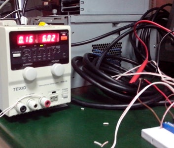

Step 2: Breadboard and Blurry Scope Shot
To make sure the design really works, I wired the transmitter in a breadboard first. I powered the circuit with 6Vdc and it draws 160mA. The transistor can get really hot so you need to attach a heat sink. The receiver is just 5 turns, 6cm diameter of #18 AWG insulated wire with one end connected to a 1N4148 diode to act as a half wave rectifier. The output is connected to an LED with a 0.1uF filter cap.
The LED lights up as I place the coils near each other. I took a photo of the coils with 2cm gap. The LED gets dimmer as you increase the gap. I also took a blurry photo of the scope when I connected the probe at the connector pin of the transistor.
