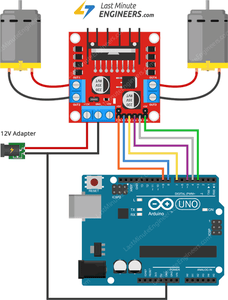

Step 4: Connecting the Motor Driver to Arduino
Using the male-to-female jumper cables, connect the motor driver IN pins and power pins to the Arduino as follows;
Motor Driver ---------> Arduino
IN1 ---------> pin 2
IN2 ---------> pin 3
IN3 ---------> pin 4
IN4 ---------> pin 5
5 V (Volts) ---------> Vin
GND (Ground) --------> GND
Connect jumper wires to the GND and 12V of the Motor driver (to supply power to the driver from a 7 -12 Volts battery). So that the Motor driver and the Arduino share a common GND.
Also, short-circuit the ENA (Enable A) and ENB (Enable B) pins on the motor driver.
Remember to hold the Arduino down to the chassis using some hot glue.
