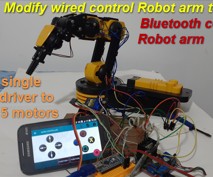

In this Instructable, I'm going to show you how to make a voice control and Bluetooth control walking robot arm. To do this I'm going to use already completed wired control robot arm. Other than the robot arm we need four wheel robot vehicle chassis to make the robot arm walk.

To walk the robot arm we need a vehicle chassis like walking base. We can use Robot car DIY kit as a walking base or make a chassis by your self. I made this chassis using hard board. Used 2 gear motors with tyres to move vehicle forward and revers. Also servo motor with attached tyres to steering the vehicle left and right. Using 4 gear motor also this can be done. That base design is up to you but that base should have enough space to put robot arm, Arduino board, Motor drivers and Batteries.
Step 2: Prepare Robot Arm
Robot arm is a main part in this project. You can make a robot arm using servo motors or buy a wired control robot arm and finish it. According to the nature of the robot arm, the supporting items for this project will vary.I'm using a wired control robot arm for this project and due to that three L298N motor drivers are required.
If you using wired control robot arm you can use that battery case for this project or use that space to put Motor drivers and Arduino board. But or all 3 motor drivers this space not enough. So you may need to attach additional items to fit motor drivers. For that you can use perspex board and nut and bold to connect those.
You can watch attached video to see how to assemble wired control robot arm if you not familiar with that.

This is a brief description about the mobile application. With this application you can control 5 arms and vehicle forward, backward, left, right and light on off and vehicle speed using Bluetooth. There is a on-off switch in the top called "Voice". Approach I used in this project is when voice button switch off then the project work with app contains control buttons. If voice switch on then buttons can't control the robot. You have to click on "Press and Speak" button and then speak the command. According to voice commands robot will work. Voice commands will discuss in coding step. This application send any text recognized. So any voice commands you can use in Arduino code.
