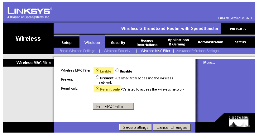

Step 1: Wireless MAC Filter
First, have all the computers you want to access the wireless feature turned on and connected to the network. You can add others later on, but I like to do them all at once
Next, access your router's settings. The standard Linksys address is 192.168.1.1. If you don't have a Linksys router and don't know the address, you can probably find it online.
Go to the WIRELESS tab, and access the WIRELESS MAC FILTER panel. Select ENABLE and then PERMIT ONLY. Don't save settings yet. Click the EDIT MAC FILTER LIST button.
