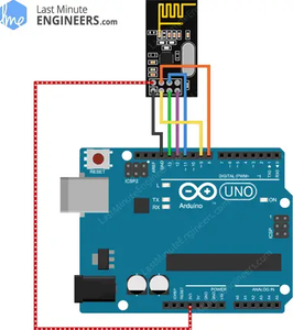

Step 1: Wiring the RF24 Transmitter and Receiver
Here is a circuit diagram that shows how to properly wire the RF24. The same wiring is used for both the transmitter and receiver.
Step 2: Wiring the Radios
Here is a table that explains how to wire you RF24 transmitter and receiver. The table explains where each RF24 pin connects to the Arduino pins. It also explains the function of each pin and explains what it does.

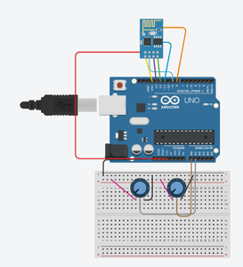

Step 3: Wiring Potentiometers to Transmitter
Here is a wiring diagram of how to wire potentiometers to the arduino using your transmitter RF24. On the right is a table that explains where to wire each potentiometer pin and explains what each pin is used for. To wire the RF24 follow steps 1 and 2.
