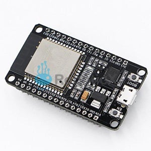

  • esp32 devkit

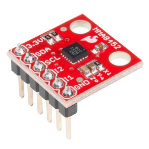

  • MMA8452Q 3-axis accelerometer

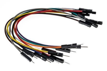

  • jumper wires

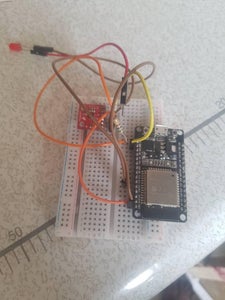

Step 1: CONNECTING THE COMPONENT
  1. connect the esp32 gnd with the gnd of the accelerometer
  2. esp32 3.3v with the 3.3v of the accelerometer
  3. esp32 gpio pin D21-SDA with the SDA of the accelerometer
  4. esp32 gpio pin D22-SCL with the SCL of the accelerometer
  5. esp32 gnd with the cathode of the led using 560 ohms resistor. the resistor should not be less than 230 ohms and the anode of the led can be connected to the 3.3v of the esp32
