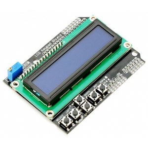

1.4.2 inc lcd
2.Arduino uno
3.LCD module for display

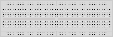

4.900 Pin bread bord

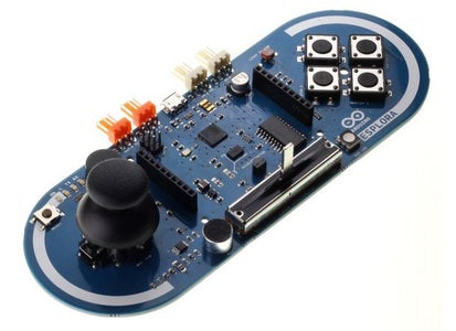

5. Arduino esplora microcontroller game bord module joysic and slider

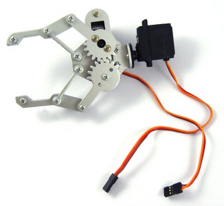

6.Robot arm gripper

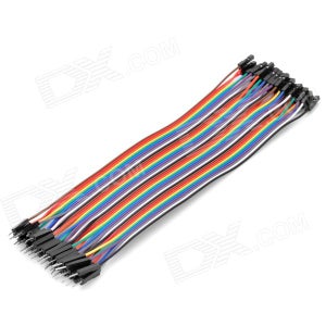

7.Jumper wires

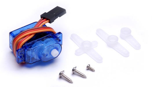

8.MIcro servo x 10

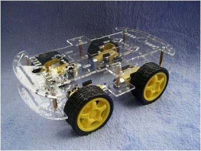

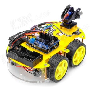

9.Robnt body

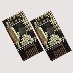

10.NRF24lL01+2.4ghz antenna wireless transmeter module

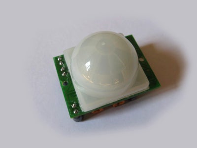

11.RIP motion sensor

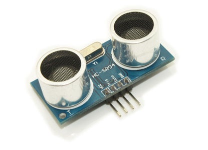

12.Ultrasonic sensor

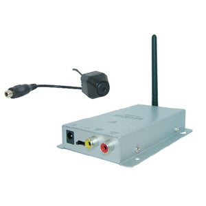

13.Wireless camera and recever

Step 4: Programing Wireless Controller
(Transmeter)
- WHAT IT DOES: Reads
Analog values on A0, A1 and transmits
them over a nRF24L01 Radio Link to another transceiver.
1 - GND
2 - VCC 3.3V !!! NOT 5V
3 - CE to Arduino pin 9
4 - CSN to Arduino pin 10
5 - SCK to Arduino pin 13
6 - MOSI to Arduino pin 11 Transmeter
7 - MISO to Arduino pin 12
8 - UNUSED
