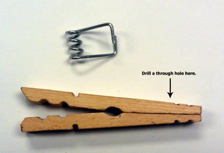

Just for fun, I make a telegraph key using a wooden spring type clothes clip, two M3 screw nuts, one M3X8mm screw and one M3x12mm screw, two M3 washers, a couple pieces of hook up wire, some double-sided tapes, and a piece of plastic board. (picture 1)
Pull the clothes clip apart, then place two wooden pegs together and dill a hole.  The hole should be just a little bigger than the screw you use. Use a smaller drill bit to drill a hole near the corner of the plastic board, and use M3 screw tap to tap the hole. (picture 2 and picture 3)
