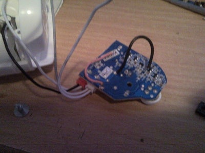

Step 1: Digitized Sensor Input
http://www.instructables.com/id/Re-purposing-an-Air-Wick-Freshmatic-Compact-i-Moti/step4/Aproach-1B-Digitized-Sensor-Output-Small-Module/
Tnx Doug Paradis, this step gave me some trouble.
I only changed a part of his method, I just used some solder and no drilling.

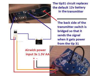

Step 2: The Idea
EDIT: I recommend you add a power switch between the center tip31pin and the negative circuit contact, the circuit loves to eat batteries!
The tip31 can be replaced with 2n3055 :)
