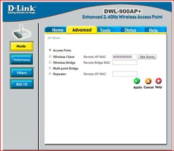

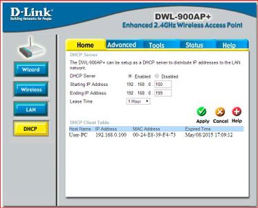

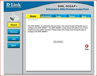

First, connect you Router/Access Point to your computer via ethernet cable and power it up. Then, type the Router/Access Point's ip address into the browser bar of your web browser (you can find the ip address of your device by looking up the manual) sign in using default of set login info. Next, set your device as an access point. Turn on DHCP and set a starting ip address. Remember this address. It is now safe to unplug your device.

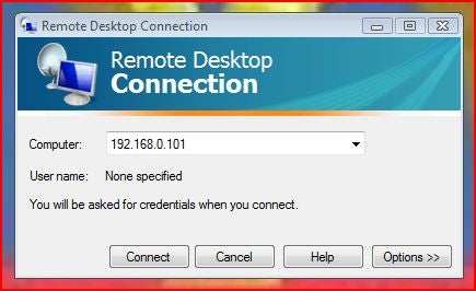

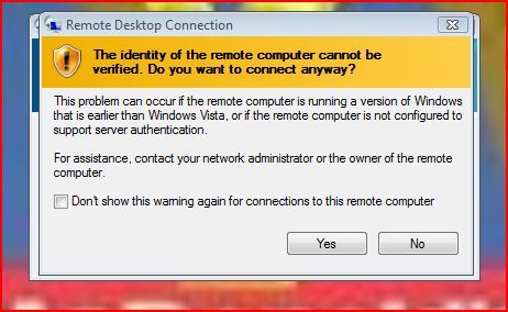

On your computer or tablet/phone, connect to your access point's wifi. After you are connected to the wifi, open the remote desktop application on your computer or tablet/phone. Type the DHCP server ip address you set earlier into the ip box, then click connect. You will hopefully be asked for your Raspberry Pi login information. If not, make sure you entered the right ip address into the address box.
