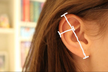

Step 3: Measurements
To be able to let this ear cuff fit properly, you'll need to measure the width and height of your ear at the places shown on the image. It can be helpful to get someone to measure this for you, ears aren't exactly the most reachable things.
