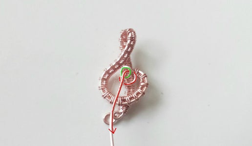

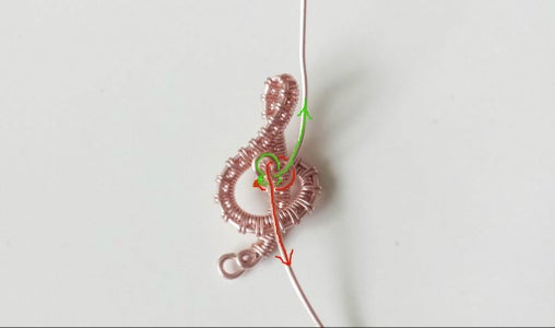

Step 8: Treble Clef: Central Loop
Use your fingers to curl the woven wire into the center loop. Do this little by little: weave a bit and curl it, then weave some more if necessary and continue curling until you have all the woven parts that you need.
Once you've woven enough, insert the wire ends behind the S shaped initial curve and up as shown in the third image above. Then pull the wire ends all the way up and to the right so that you get what's shown in the fourth image above.
Step 9: Treble Clef: Finishing Up Wire Ends
To finish up the wire ends, I decided to add some swirls to the center. Curl the right thicker wire upward and to the left like shown in the first image. Then curl the left thicker wire up and around the right wire loop like in the second image (hard to see, but the wire going up is the left wire and the wire going down is the right). Cut the left wire short and fully curl it into a complete loop around the right wire as in the third image. Then cut the right wire short too and fully close it into a loop.
