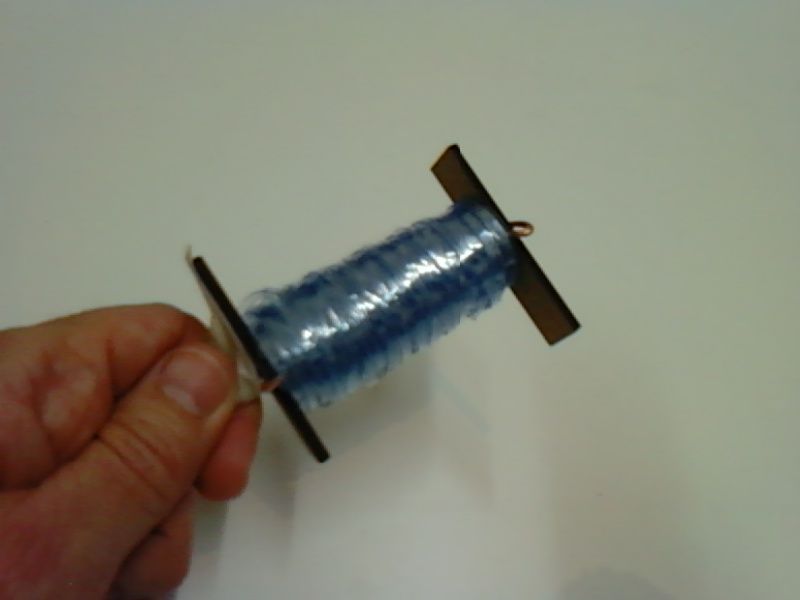

Copper wire 0.5mm (5-6m)
Copper wire 1mm (0.5m)
