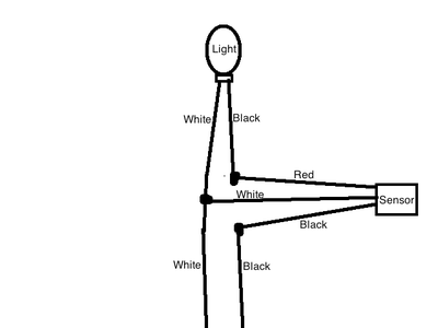

I bought a photocell sensor on eBay after learning Lowes, Home Depot, and Walmart were either out of stock on them or did not carry them.  No problem, I thought, 3 wires and it should come with instructions.  It arrived, but with no instructions except on the little plastic part (see second photo).  I am NOT an electrician, but usually can handle easy projects.  If it had 2 wires, it should be easy, but with 3......that's a problem.  I went online to instructables, Youtube, and a few other sites.  Although I could not find anything showing what I needed, I did gather enough to attempt it.  Here is my wiring diagram ( third photo) and instructions:
CAUTION: BLACK WIRE IS 120 VOLTS, SO TURN OFF SWITCH OR CIRCUIT BREAKER.
Connect sensor's black wire to black wire coming from house.
Connect red sensor wire to light's black wire .
Connect all 3 white wires (from house, from sensor and from light) together.
Now wasn't that easy. :-)

The photo is blurry. I’ve attached a hand drawing.

Red always goes to the black of the light.
Sensor black goes to inbound "line" black. Whites all are tied together as are the grounds. I posted a much more in depth explination higher upGood luck

The red wire should be directly wired to the HOT circuit supply wire the black wire should be connected to the black wire on the lamp you are trying to illuminate and the white to neutral.

Hi there, Firstly, safety safety safety!  Electricity is always trying to get back to the earth/ground, we're just caging it and controlling it to do work for us before allowing it to go home. Preferably our body isn't what connects that electricity to the ground.  Good practice for DIYers is wear rubber soled shoes or similar insulating shoes and even stand on an insulating mat of rubber or similar if you have it.  Remove lose jewelry and rings tie back longer hair etc....you really set don't want an arc welded wedding ring stuck on your finger and the switch box and still at 800°F or more.
⁰)Turn the circuts power off at the breaker so there's no power to the circut you're going to work on....not just turn the switch off thinking it's then safe (half of that switch even when turned off carries 120 volts at 15-20amps.... well beyond lethal electrocution levels. Remember a little taser uses just a a little 9volt battery but that's a discussion for another time on volts amps transformers and capacitation).  Now if you're the type to make toast while taking a bath I'll understand why you ignored this most important rule...the rest of you...drill it in your head...no matter how small or fast the fix is  Always turn the power off at the breaker.
Now to the wiring.
The black going into your light switch is the "line" it's the 120v inbound line. Then your light switch should have another black out of it, a white neutral (think of the white as another ground wire that's taking the long path to ground back at the breaker panel where the white and your bare copper ground wires all become 1), and a ground wire that's typically a bare copper wire in and sometimes a green wire;
¹) whenever possible I will always try to connect my grounds first, they are a sort of safety net if you screw up or if something is miswired elsewhere or a short occurs, because electricity ALWAYS takes the path of least resistance getting to that ground and thankfully copper wire has less resistance than human flesh.
²)When turned on the light switchs' outbound black becomes the a continuation of the "line" relative the photocell...so wire those 2 black wires together.
³)The photocells red wire (its "line") you will wire to the black wire that comes from your light fixture.
⁴) sum all the whites together (1 at the wall mount or similar, 1 from the photocell, and 1 from the outbound or "load" side of the switch minimum.
⁵)check all your connections one last time with a gentle tug.
⁶) If you have 2 light fixtures you'd have another white to sum at the wall box and another black to tie in with the first light fixtures black to the photocells red wire, and another ground wire.
Hope this overly wordy response help clarify.  Good luck and BE SAFE!
