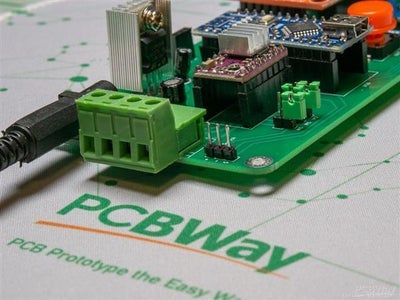

Step 8: Turn Your Prototype Into a Professional PCB With PCBWay!
You can make high quality PCBs from PCBWAY
Upgrade your electronics project with a custom PCB for better durability, performance, and a clean layout.
Why Choose PCBWay?
✅ Fast Turnaround – Quick fabrication & shipping.
✅ High Precision – Superior quality manufacturing.
✅ Affordable Pricing – Budget-friendly for all projects.
✅ PCB Assembly – Get components pre-soldered.
✅ Instant Quote – Upload Gerber files & get pricing instantly.
🚀 Bring Your Ideas to Life! Order now at PCBWay.com (CLICK here)
