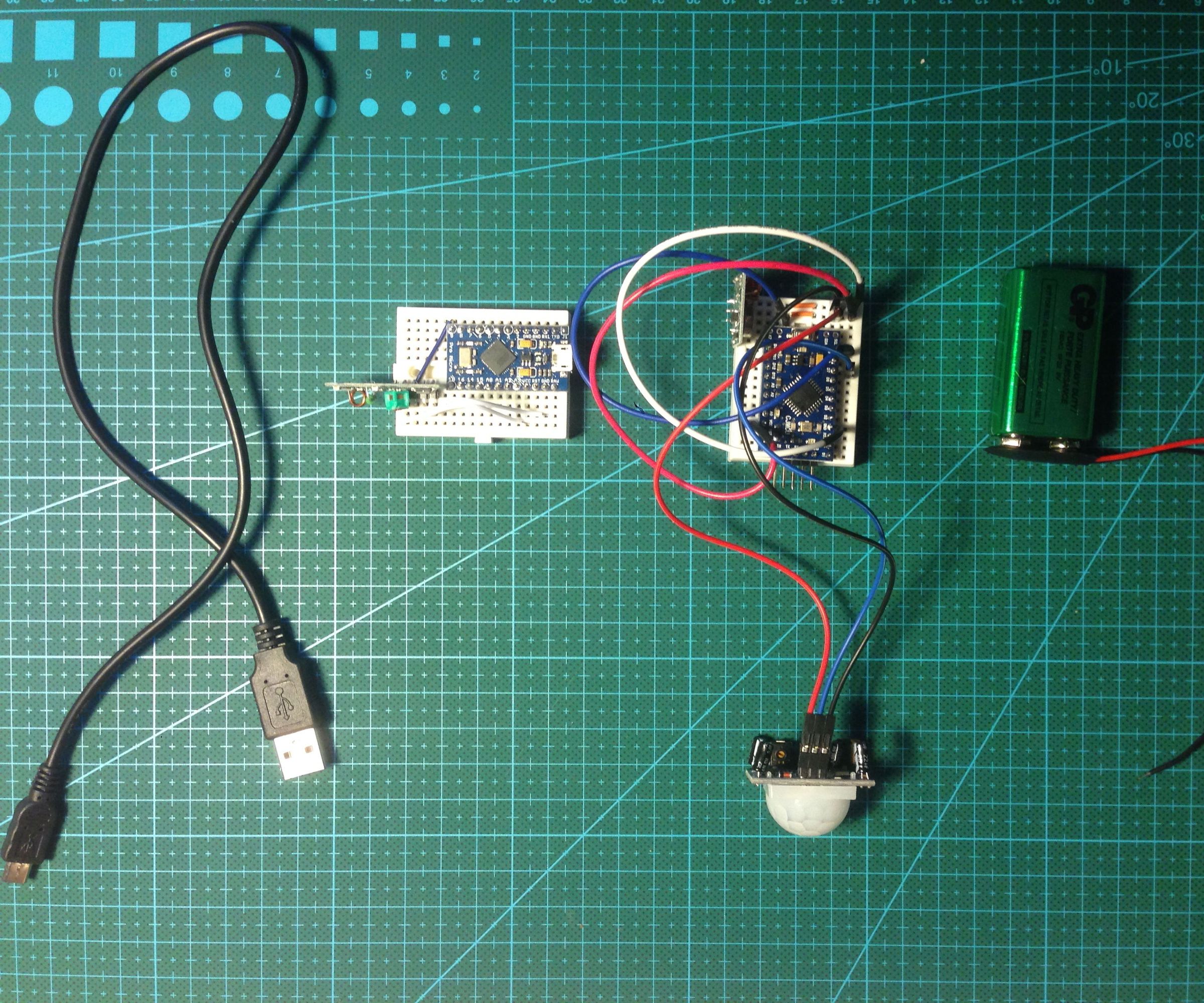

Step 1: Parts and Materials
Parts list:
  • Arduino pro micro(to keep it small)
  • PIR sensor
  • USB cable
  • Jumper wires
  • elastic (optional)
  • computer or laptop (only support Windows OS)
The parts for this project should be under 50 RMB. All the parts should be easily to find in Taobao or ebay.
Step 2: Build the Circuit / Wire the Parts
the wiring is pretty straightforward.
  1. connect Arduino GND pin to the PIR sensor GND pin
  2. connect Arduino VCC pin to the PIR sensor VCC pin
  3. connect PIR sensor OUTPUT pin to Arduino digital pin 10 (I choose pin 10 because it's on the edge but you can pick whatever Digital pin you like)
