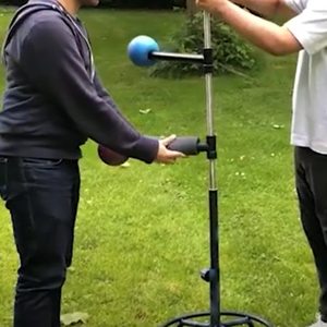

The juggling system is designed to be used by people of all abilities. Its smooth rotation, facilitated by bearings, allows users to interact with it effortlessly. To play, individuals simply push the balls attached to the tower, initiating a rotation around the steel tube. As the balls move, they create a dynamic and engaging experience, encouraging users to interact with the tower in various ways. Whether it's practicing juggling skills, improving hand-eye coordination, or simply enjoying the sensory feedback of the rotating balls, the juggling system offers a fun and inclusive activity for everyone to enjoy.

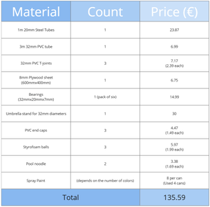

Materials:
- 1m of 20mm steel tube
- 300mm of 32mm PVC tube x3
- 725mm of 32mm PVC tube
- 32mm PVC T-joint x3
- 32mm PVC end caps x3
- 8mm Plywood sheet
- Umbrella stand suitable for 32mm PVC
- Six bearings (32mmx20mmx7mm)
- Acetone
- Styrofoam balls x3
- Pool noodle
- Spray paints

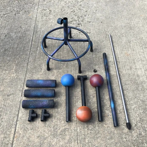

Step 1: Preparing the Subassemblies
Here are the subassemblies before the main structure assembly:
1) Preparing the 20mm Steel Tube
2) Attaching Ball Bearings with T-joints
3) Making Extension Tubes with Styrofoam Balls and Pool Noodles
4) Preparing the Steel Tube End
These subassemblies are essential steps in preparing the various components required for the final assembly of the juggling System.

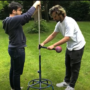

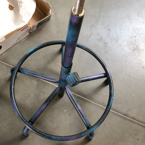

1. Tighten the PVC Tube in the Stand:
Secure the 32mm x 725mm PVC tube in the stand, ensuring the bottom end touches the bottom of the stand for stability.
2. Insert the Steel Tube into the PVC Tube:
Insert the steel tube into the PVC tube, ensuring that the wooden piece snaps snugly into the PVC tube.
Level the top of the steel tube with your eye level to estimate the height.
3. Lock the Steel Tube with the Wooden Cutout Ring (Piece 2):
Pass the wooden cutout ring from the top of the steel tube and lock the steel tube with the top of the PVC tube. This minimizes wiggling in the structure and provides added stability.
4. Sliding the T-Joints to the Steel Tube:
Pass the T-joints from the top of the steel tube to the desired height. There may be some resistance while pushing, but the T-joints will stay in place when released at their required height.
5. Attach the Tube Extensions to the T-Joints:
Attach the tube extensions with the T-Joints to complete the assembly.
Once assembled, the juggling system is ready for use. Enjoy practicing and refining your juggling skills with this sturdy and functional structure!

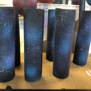

Base Coat:
- Start by spraying all the components, except the steel tube, with black matte spray paint.
- Allow the black base coat to dry completely.
Adding White Spots:
- Use a brush to create white dots over the pieces.
- Swing the brush lightly all over the components to achieve a scattered pattern of white spots.

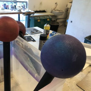

Coloring the Balls:
- Use spray paints to color the balls.
- Use the assembled extension arms to facilitate the handling of the balls during the spraying process.
