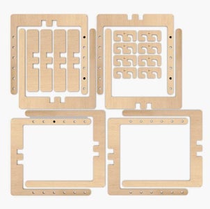

Step 4: LASERCUT ARRANGEMENT
This is the best optimised way to arrange a complete set of parts on a poplar plywood sheet measuring 600 x 450 mm.
This optimal arrangement allows a complete set to be manufactured per plywood board, while minimising material loss.
This efficient arrangement ensures that each sheet is used to its maximum capacity, leaving hardly any residual material and making the production process both cost-effective and sustainable.
In this way, it is ensured that each plywood panel is used in the most economical and environmentally friendly way. The design of the blocks to regulate the height have been slightly changed due to ergonomical issues, but that doesn’t change anything about the layout.
