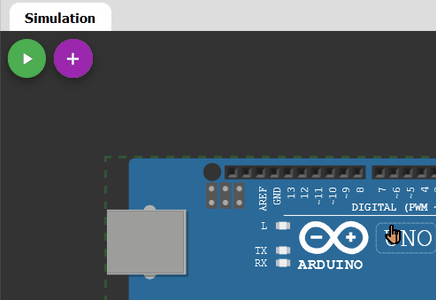

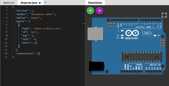

Step 1: How to Add a Part to the Wokwi Arduino Simulator?
To add the part, you just have to click on the purple "+" button. You will find the button at the top of the diagram editor.

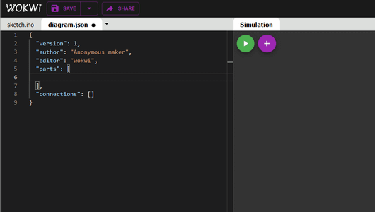

Advanced users can add the element in the diagram.json file.

Step 2: How to Move the Parts on the Wokwi Arduino Simulator?
To move the parts around, simply click and drag the parts to the desired position. You can click and hold the part, move it to the desired location and release the mouse click. You cannot move the parts when the simulation is running.
Advanced users can move the element in the diagram.json file. Sometimes, when building complex projects this will help a lot.

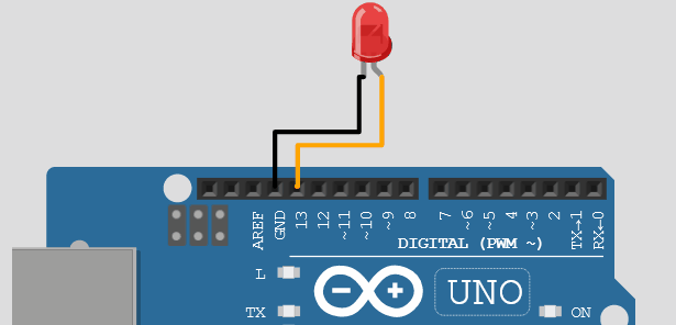

Step 5: How to Add a Wire (connect Two Components) in the Wokwi Arduino Simulator?
To create a wire between two parts, just point to the pin/pad where you want to start the connection from. Click on the destination pin/pad to complete the connection. Advanced users can also connect the two pins using wires by editing the 'diagram.json' file. By default, the color of the wire is green. You will find ways to change the color in the below sections. If you want the wire to go a specific way you can click in the place where you want the wire to make a turn.

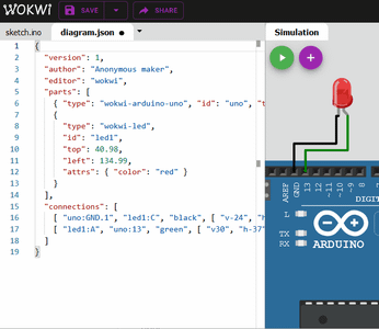

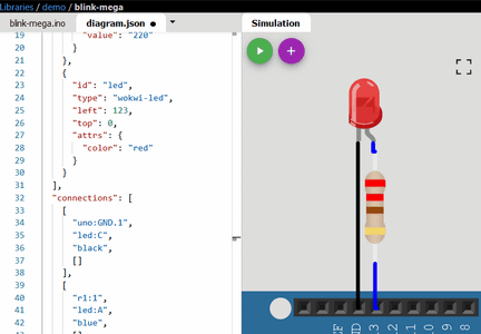

Step 6: How to Change the Color of the Wire in the Wokwi Arduino Simulator?
Changing the colours of the wire is not possible in the simulator window. You can change the colour of the wire by editing the diagram.json file. Here is how it is done

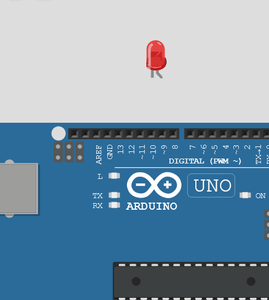

Step 9: How to Change the Colour of the LED on the Wokwi Arduino Simulator?
You can change the LED colour by editing the diagram.json file. here is one example.

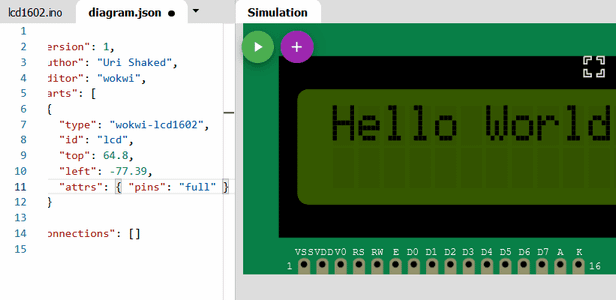

Step 10: How to Change the LCD Character Display Pins From the Full Version to the I2C Version on Wokwi Arduino Simulator?
There are a lot of tricks to customise what you want in the Wokwi
Arduino simulator. To change the LCD type from I2C to the full version (8-bit data and control signals)
You have to edit the digram.json file, particularly the LCD element.
The attributes part ('attrs') can be used for a lot of things. To change the LCD to I2C type, change the parameter from 'full' to 'i2c'.
If there are no parameters mentioned in the attributes, OR if there are no such attributes at all, you can add one. For more details, visit the docs page for the LCD. If you have doubts or need clarification, or have any suggestions, please leave a comment.
