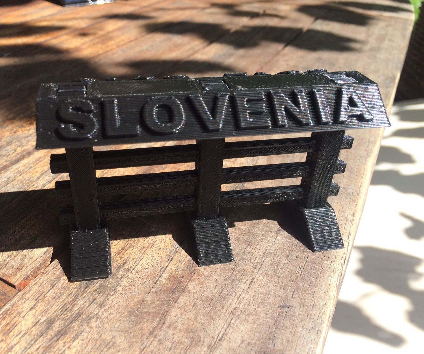

Step 5: To Finish This Off...
Having got my 3D printer built and working; I have generated some stl files to provide you with a base for the Wol Clock; also.
Please note that I have had to modify the software to make the time 180 degrees out of phase to allow the wires to be hidden in the base; and there seems to be some new changes to the time library which has made the old code no longer compatible.
OK, I won't win any photography awards, but I will hope you appreciate the base mount which hides the wires.
